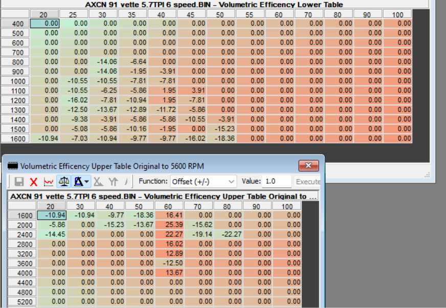

I've been looking at my VE tables. I had adjusted them some time ago and have been using that bin as the basis for everything I've been doing recently. I should have mentioned this before -- I just didn't think about it. I was focused on mechanical modifications.
Well I compared the VE tables in my bin to the stock bin. And it looks like I actually removed fuel at part throttle. Again, this tuning was done a long time ago, and my memory is not good. I don't want to change 100 things at once, so I'm first going to load the tune with the AIR disabled and the injector offsets adjusted. I've already made the bin for that I just haven't yet flashed the chip. If that doesn't bring the BLMs down I think I will put the stock VE tables back in, and go from there.
I'll attach a picture of the comparison.
This is the difference between the stock bin and the bin I'm using now. The negative numbers represent higher values in the stock bin.

Sounds good. Yeah, 160/128 = ~25% So it would take at least a 25% change in the VE tables to get your BLM's up to ~160. Maybe with your VE table mods and cleaning up these other things with the MAT and AIR and stuff, we can get this thing stabilized.

Alright good news. The VE table brought the BLM right down. I'll email you the bin and log again so you can see it.
Unfortunately, the stumbling has not changed. So at this point its probably not in the tune I think.

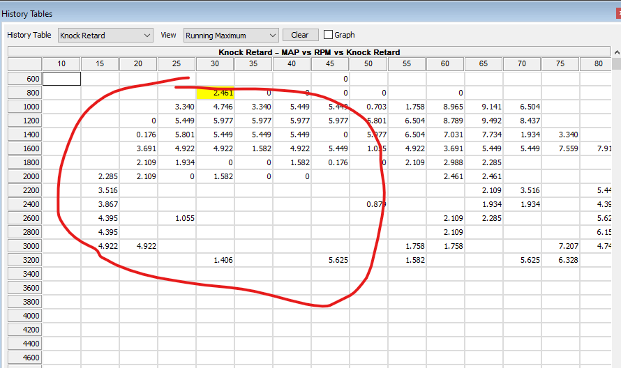

One other thing I'm noticing is that you're getting a lot of knock retard in areas that I wouldn't expect to see any... If its false knock, the ECM is going to retard timing unnecessarily, which I'm actually seeing happen in your data. The highly variable timing could also be contributing to your stumbling...
What knock sensor are you running? If you're not sure what the previous owner installed and you can't identify it, you might want to consider getting a true Delco sensor for your year Corvette.
Also, I wonder if its installed to tight (which makes them more sensitive). These things are supposed to be installed to a specific torque (14 ftlb)
I battled false knock for a bit and when I changed out my old Pep Boys special for a true Delco and then re-torqued to the right spec, it cleared right up.
