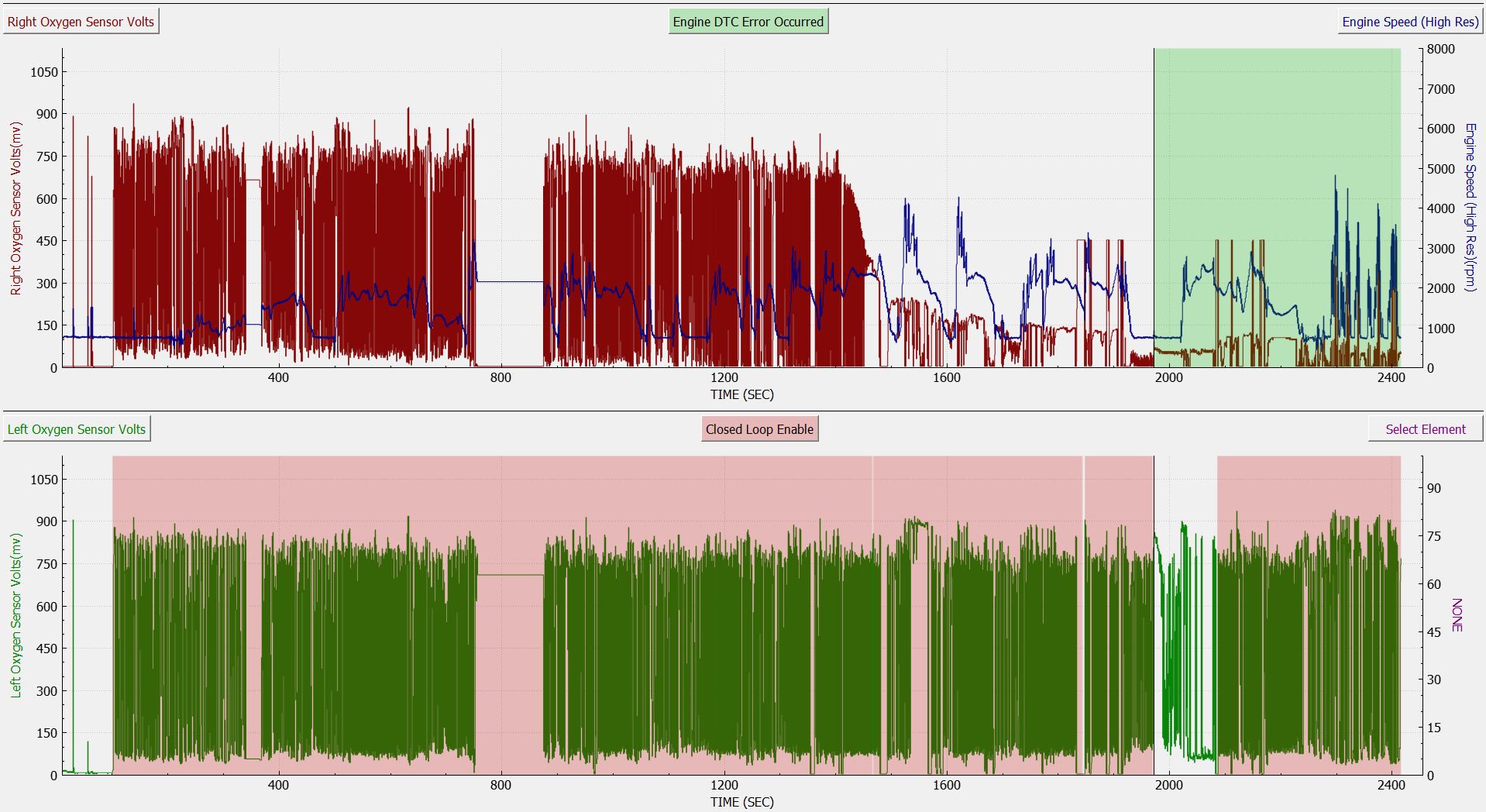

Update on this thread: I got a diagnostic cable and started data logging using EEHack. After driving around for a while, I was able to recreate the DTC #64 when idling for around a minute. The top graph in the screenshot shows the right O2 sensor voltage (red) and the engine RPM (blue) overlayed. The green window shows when the DTC #64 appears. On the car's driver info screen, the CEL disappears as an intermittent, but the datalogging software doesn't show this. Instead, look at the bottom graph's red window which shows when the car goes back into closed loop, which happens when the CEL disappears on the info screen. Also on the bottom graph is the left O2 sensor voltage (green), which shows normal operation. What's really confusing me is the right O2 sensor voltage dip beginning around 1400 sec. I have no idea what might cause this, and why it doesn't return to normal fluctuation after the CEL disappears and the car goes back into closed loop. Is this just typical behavior from a bad O2 sensor? If anyone wants to take a peek at the log file, I can send it through email or something. ALSO- just so no one is confused, there was a pause in data logging around the 800 sec mark.

Last Update: I finally got around to replacing both O2 sensors, and now there is no CEL, and both sensor voltages fluctuate rapidly like they should! When pulling the old sensors, the one reporting the lean condition was covered in soot (no surprise because it was running rich on this bank) and the seemingly okay one looked pretty destroyed by silicon poisoning. The worst thing though was that the sensors were actually different models... thanks to one of the 8 previous owners for doing that. I also cleaned out the O2 sensor contacts with some electronic cleaner spray just to get rid of any oil/debris.
