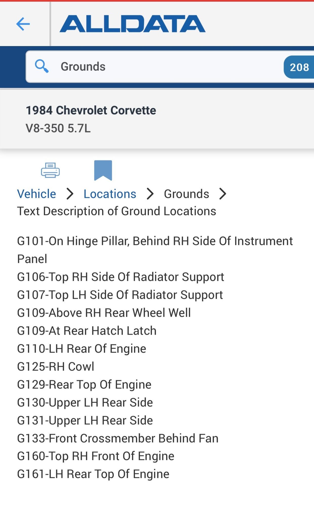

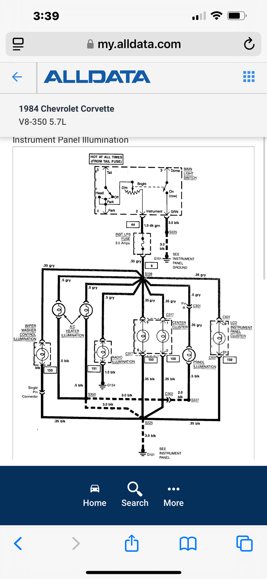

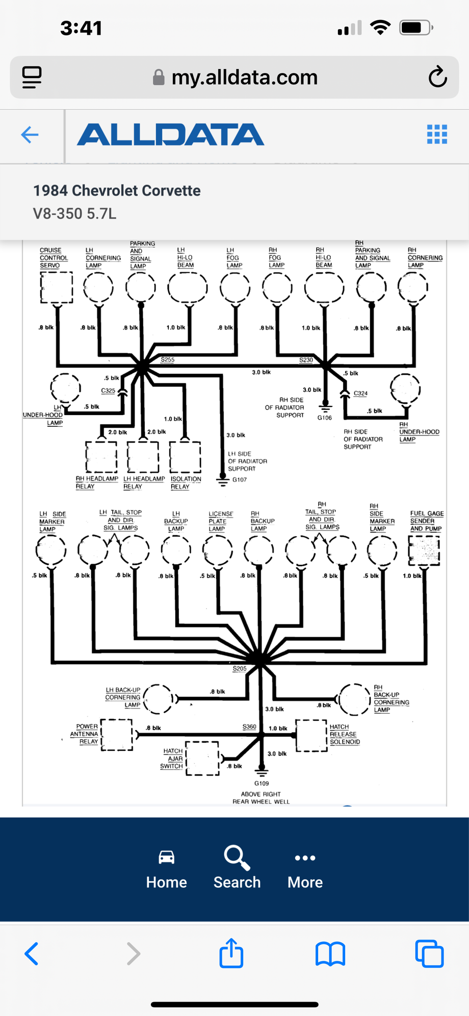

Well what you can try is if you have some jumper cables connect between the block and the frame and see if the lights still dim…if you have a DVOM connect one end to battery negative and other end to the frame while the engine is running and then apply your brakes and read the DVOM…should be no more than 0.5 volts…do the same between battery negative and the engine block.

Old Nov 28, 2024 | 03:52 PM
C5 Diag's Avatar
C5 Diag
Moderator, Tech Contributor
Posts: 15,497
Likes: 3,999
From: Cape Coral, Florida
