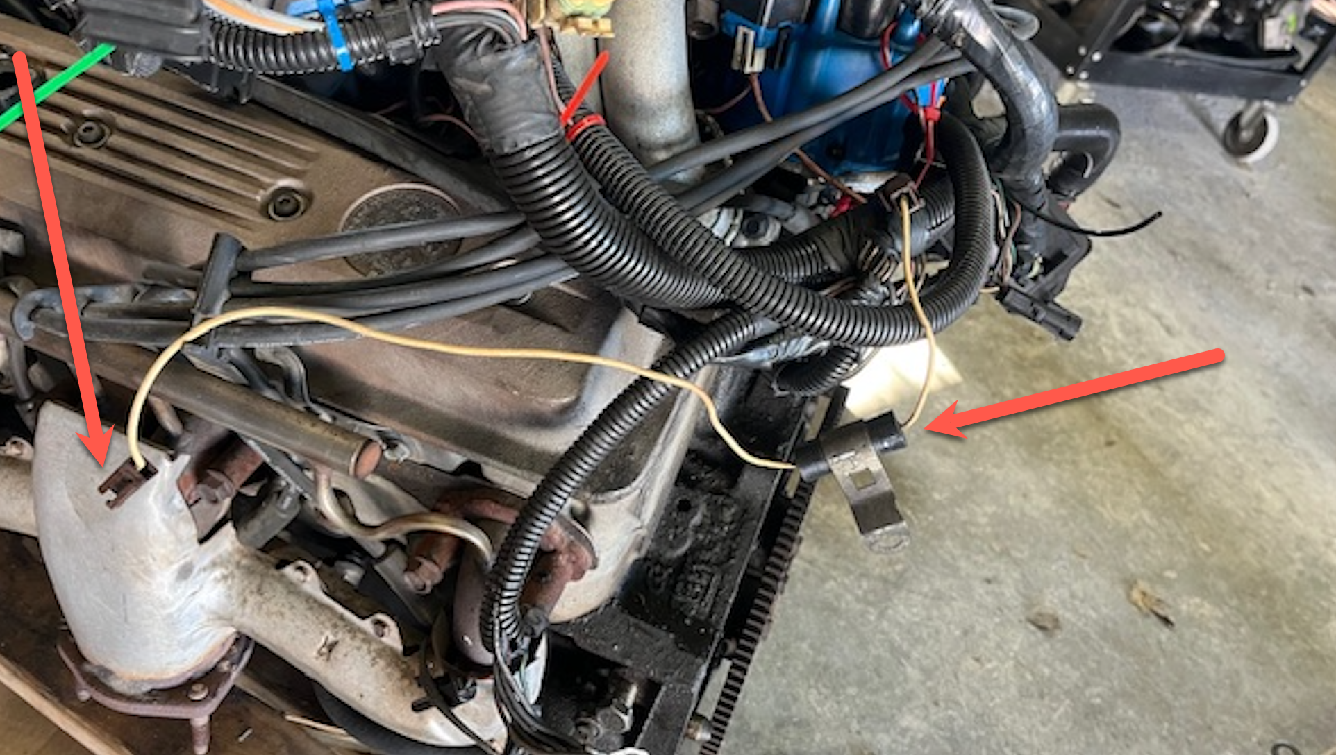

In the middle of an engine swap, taking out an L98 engine from a 1988 Corvette. Thought I labelled everything, but for some reason don't remember unplugging this one and don't know where it goes. Can anyone identify what it is it and where it goes?

That's the tach filter and it plugs in at the distributor cap, filter bolts to the rear of the left cylinder head.

Excellent! Thank you.
