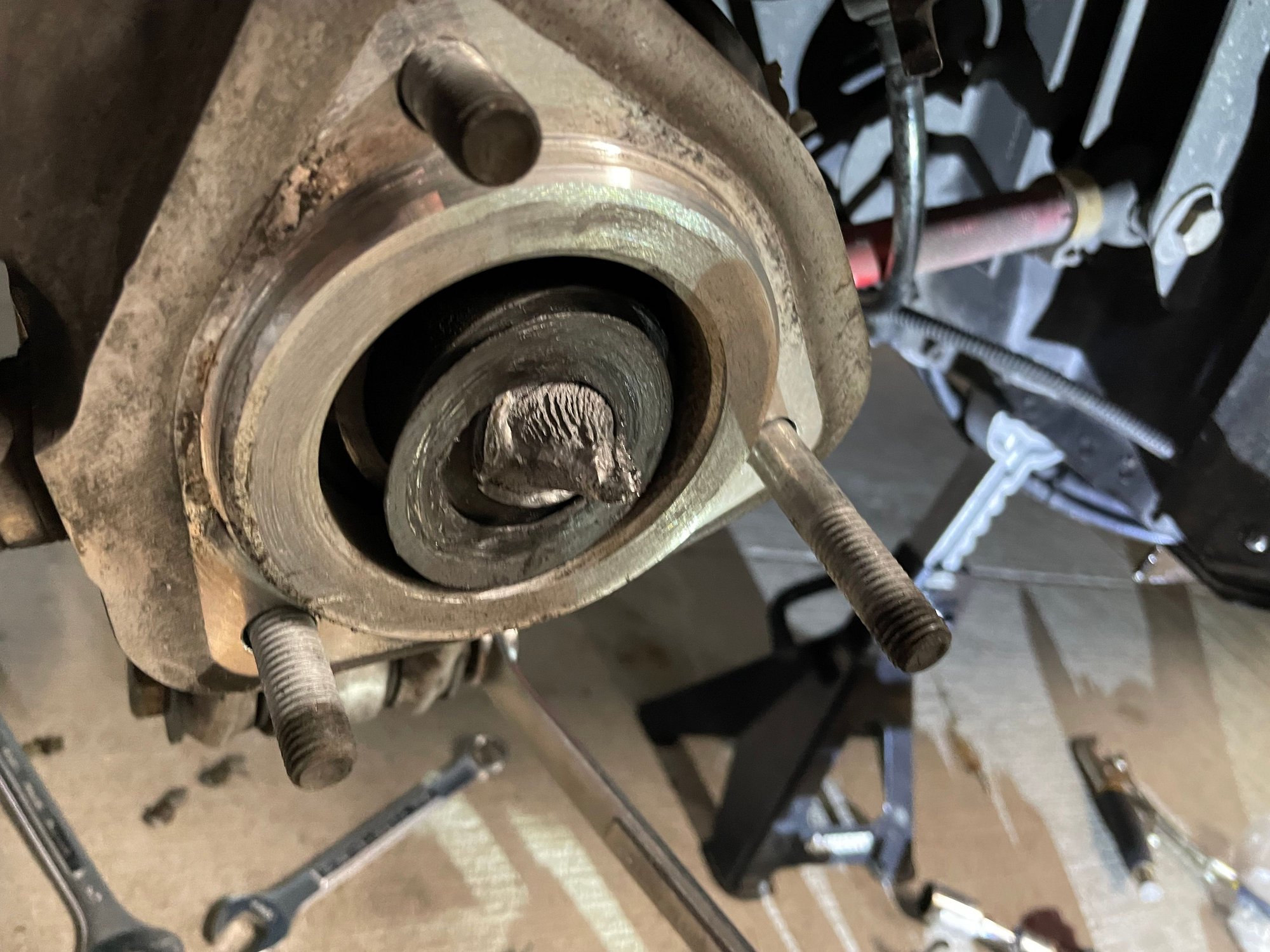

This is what I am trying to avoid at the track.
I did a test launch on it this afternoon and I didnt bog like i usually do

There is the valid argument that ‘just release the clutch pedal slower” and thats exactly what i was trying to do when i broke that outer axle stub end
so somehow that didnt work for me. So thats why I am going to try this
a few mcleod street twin users, like myself, have also broken parts
