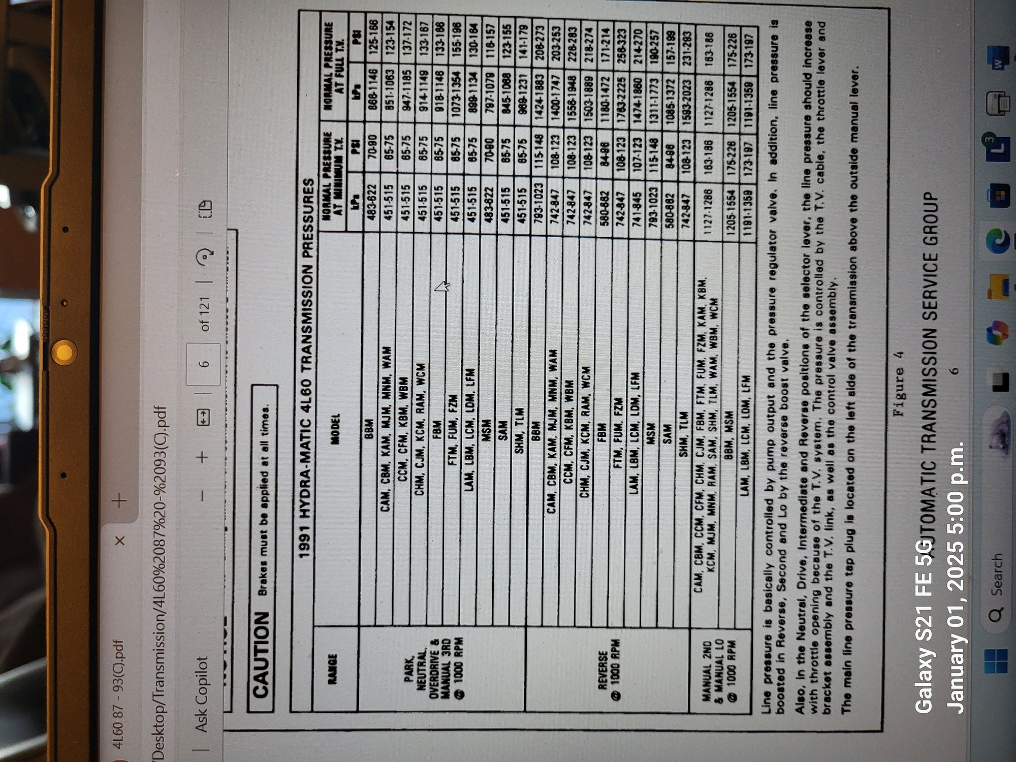

fluid level good, TV cable adjusted, pressure in park 70psi, reverse 90psi, driving 75psi, and I don’t have 3rd or 4th actually but when I drop it down into 2nd it stops slipping and pressure is about 180psi when stopped drops to 95psi at 50 and 85psi at 60.
Old Jan 1, 2025 | 06:10 PM
arbee's Avatar
arbee
Joined: Feb 2003
Posts: 2,677
Likes: 811
From: Saskatoon Sask.
Ahhh! Different info. Before you said no 2nd or 4th. If you have no 3rd or 4th, that is a classic sign of 3-4 clutches done for. I have included the pressure chart for your trans.

[QUOTE=arbee;1608455084]Ahhh! Different info. Before you said no 2nd or 4th. If you have no 3rd or 4th, that is a classic sign of 3-4 clutches done for. I have included the pressure chart for your trans.
The way it felt when it was slipping had me thinking something else was off, I paid closer attention for the test drive with the pressure gauge installed. Looks like I need to find a different trans or get this one rebuilt.
