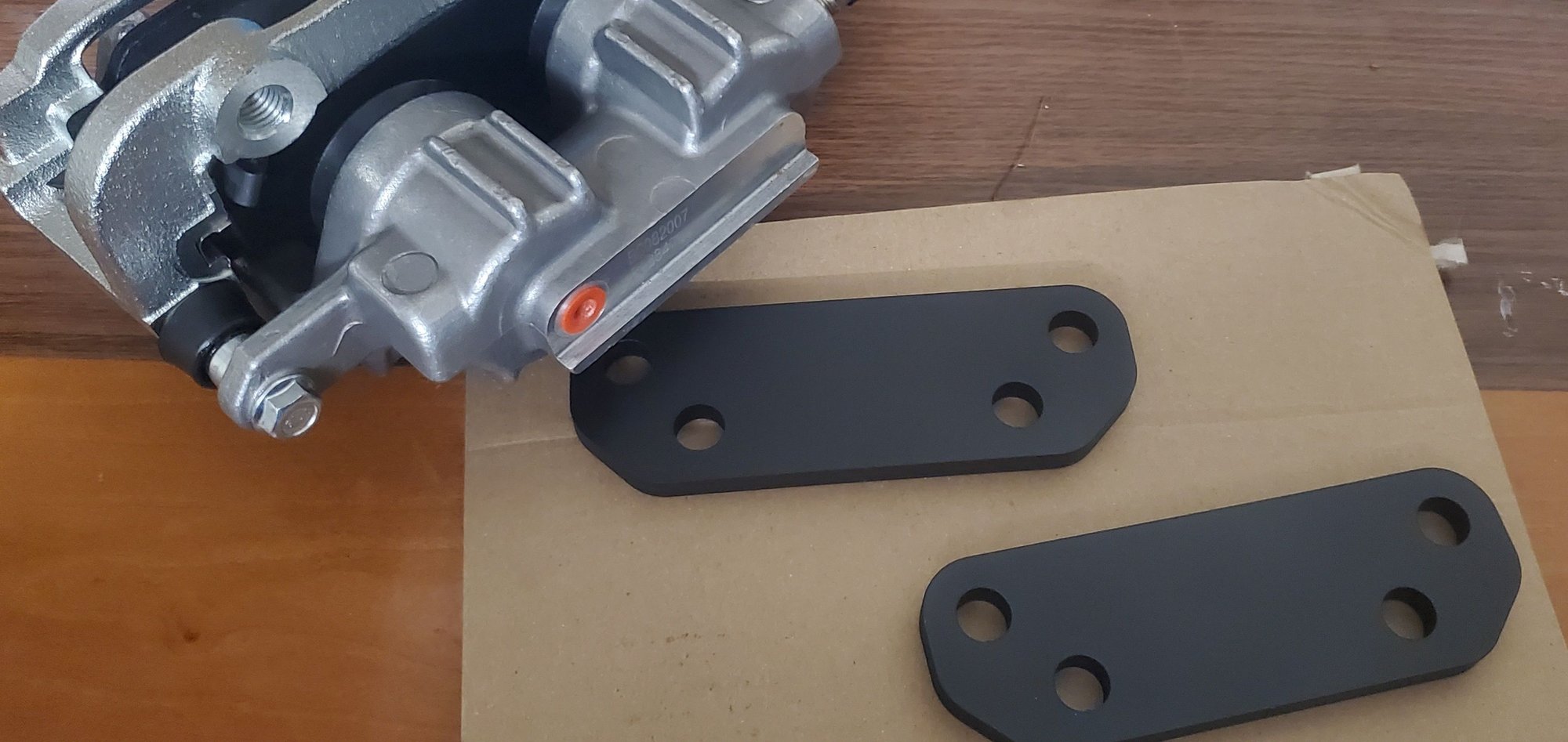

The brackets I bought from SendCutSend bolted up great except that the factory caliper bolts (which work just fine on the Camaro/ATS caliper) are larger than the holes I ordered drilled. I have to hog them out to 5/8". I will take some pics of that. I don't think I cam going to have too much clearancing of the caliper, but I haven't gotten that far yet.

No, I got it from a guy here on the forum. There is a link in the post to the file. Just upload it to SendCutSend, select your material and you are off and running. Turns out it was $41.50 shipped.
https://www.corvetteforum.com/forums...p-84-87-a.html
I am not sure they will work on the 94 though. But you get the idea. It is just a flat piece of metal with two sets of holes: one for the factory mount to the spindle and the other for the caliper.

I got the driver's side installed. I used the factory banjo bolt and the factory line. The factory caliper bolts are too long so I had to use some washers to make sure it tightened up just fine. I also had to clearance the back of the caliper on the back where it interfered with the SendCutSend brackets. I could have ground the brackets but that material is exceedingly hard. Aluminum is much softer so that is what I went with. The caliper and pads could accommodate 3/8" more rotor, so 14" rotors work fine, but if you found a little larger rotor, it would work. But then you would have clearance issues with it running into the caliper where the rotor sits so I am ok with what I got. The pads contact the full interior of the rotor. No clearance issues with the 18" wheels either. I will upload pics tomorrow.

Updated with pics. I will take a picture of the passenger caliper where I do some clearancing later.
