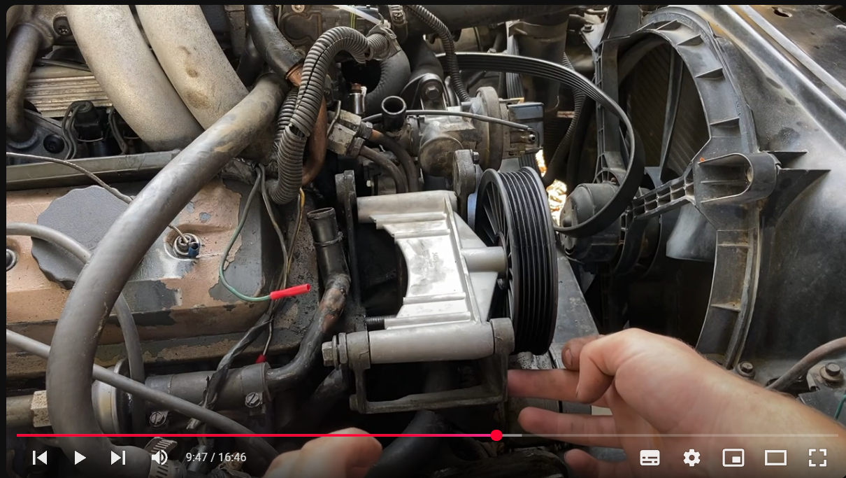

So i was looking in to deleting the ac system in my 1988 c4 corvette. Its a r-12 system that doesn't even work and I think the engine bay looks way better without it in there buuuuuut ive run in to a hiccup I have a L98 so with some little research I find the bracket bing bang boom we are in business but before i ordered it I went out and looked at my ac compressor and realized its mounted differently from the other l98 vetts ive seen its mounted with 4 bolts and soo I dig a little further and found that I would need this bracket (https://tpis.com/collections/pulleys...28342559735880) but its not made any more. So I was wondering if this ac bracket and ac delete would be compatible in my car I haven't seen a video online of the actual ac bracket itself and how it mounts but to my understanding the c4 corvette l98 only had one belt size so there's no reason this shouldn't work right? would love to hear any opinions

If you are thinking about deleting the Air Pump as well it can be done without any pulley kits. Use the search on this site.
