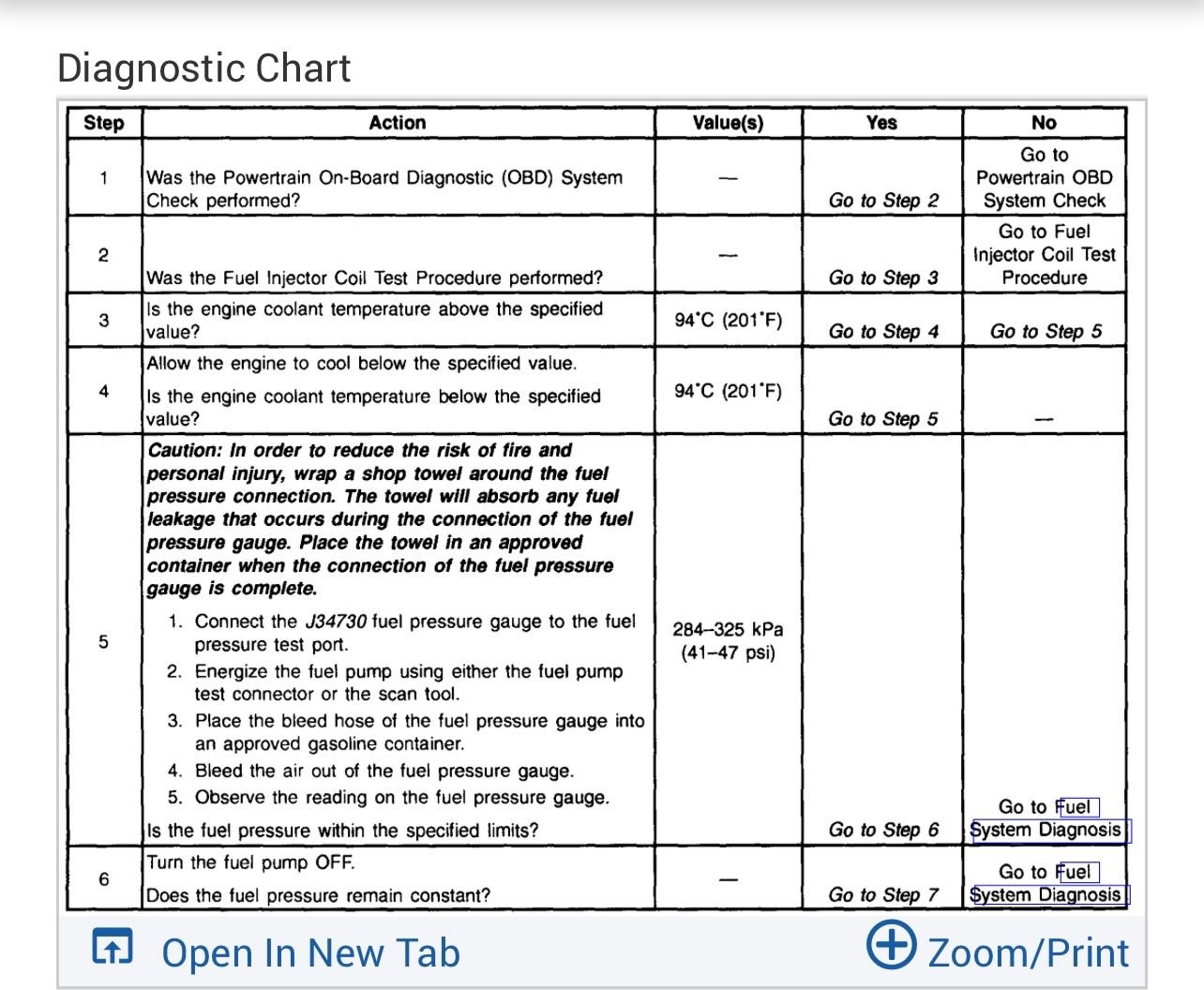

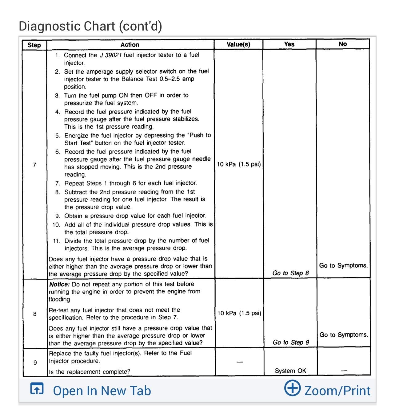

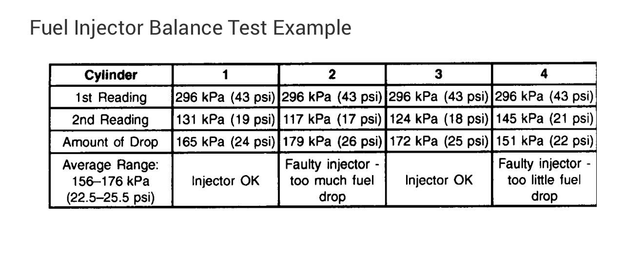

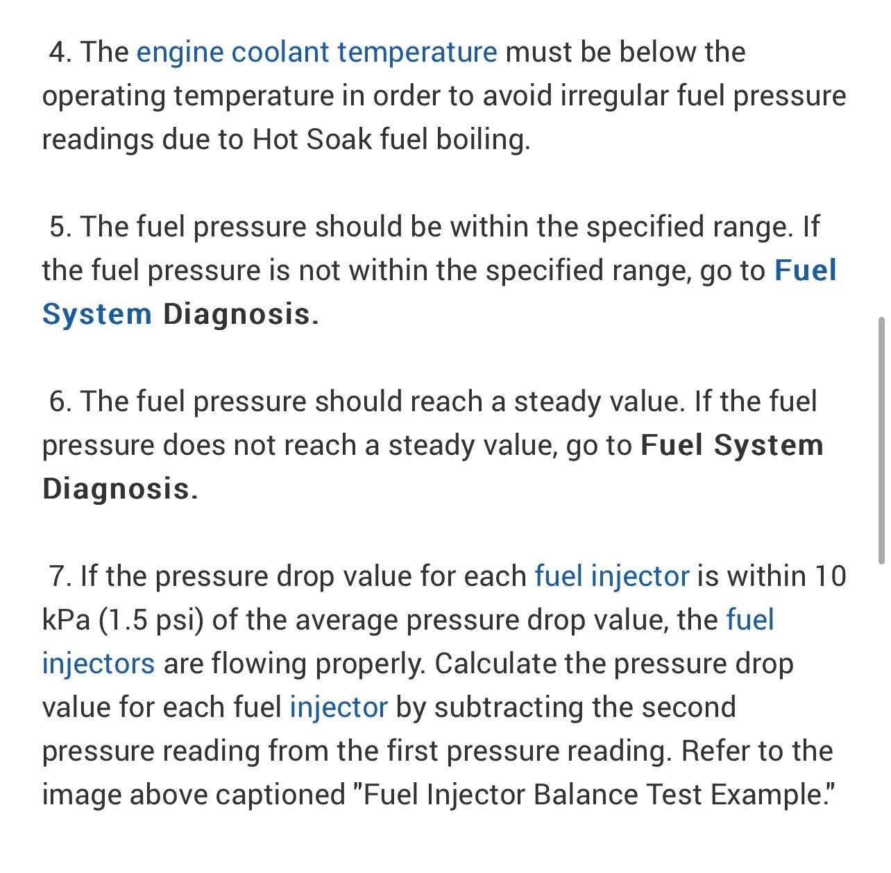

Old Jan 19, 2025 | 03:22 PM
C5 Diag's Avatar
C5 Diag
Moderator, Tech Contributor
Posts: 15,621
Likes: 4,066
From: Cape Coral, Florida
More info in regards to the procedure.
