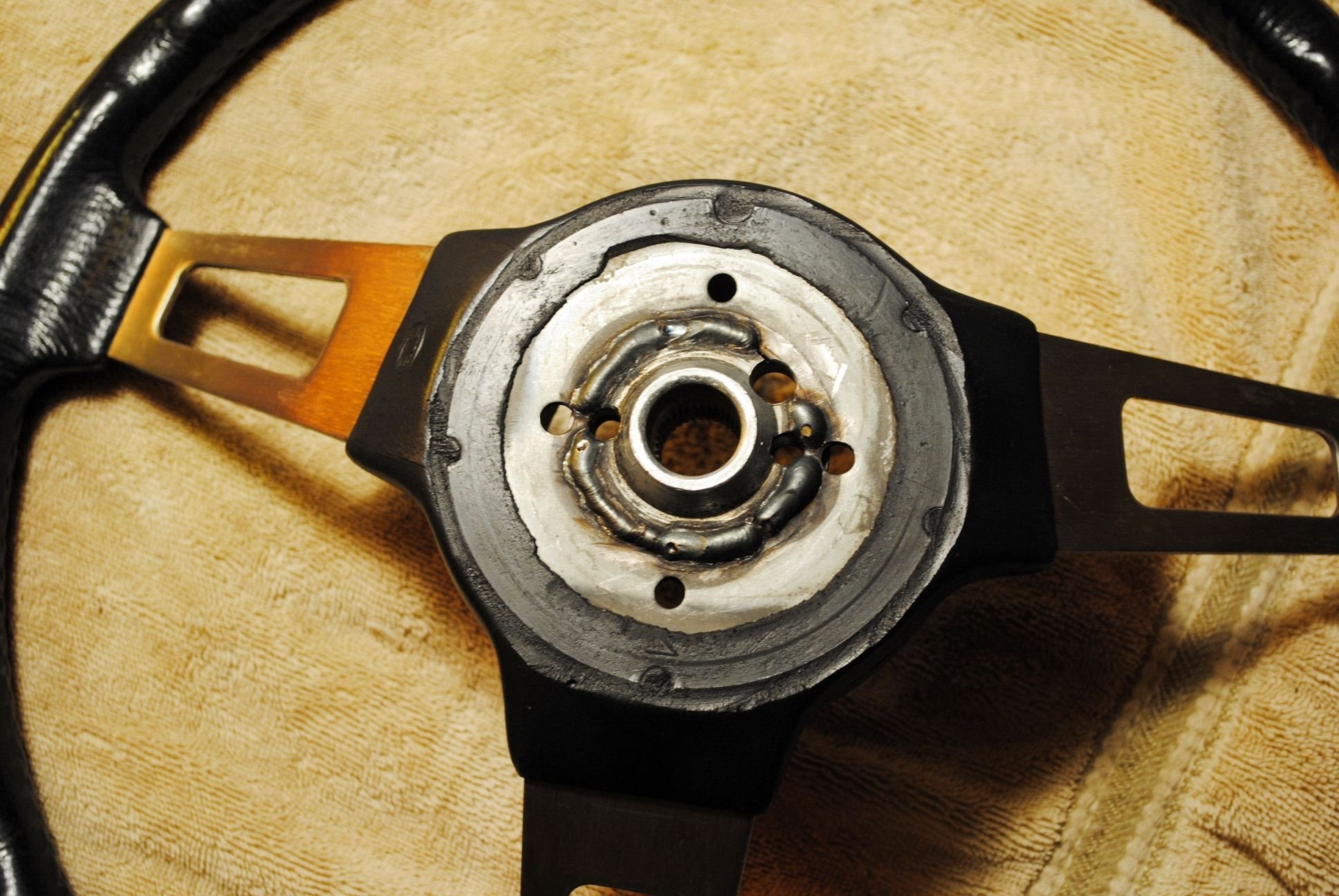

Years ago while I was crawling a wrecking yard of old cars when it still existed, I found what I thought was a pretty cool three spoke sport wheel in what I remember was an old Opel. I brought it home to try in my GTO and found that the splines didn't match my GM column (if you're thinking that wait--Opel is GM, keep reading) so I went and got a gross wheel out of some 90s Grand am, cut the hub out of it, and welded it into the Opel wheel after drilling out its stock hub. I ran the wheel in my GTO for a good while but recently decided to try something else in it so this wheel has been on the shelf.

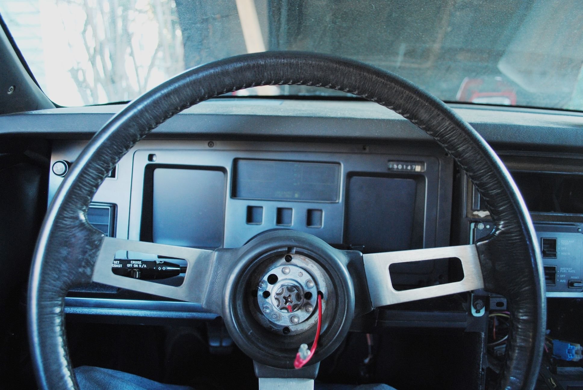

Anyway, the wheel came with a 3-horn button spider that fit through the spokes from the rear but I pulled that off immediately and for this application I'll be adapting my stock Corvette horn cap to it. To my utter delight it's a perfect fit, diameter wise. Here's a shot of it mocked up in the car:

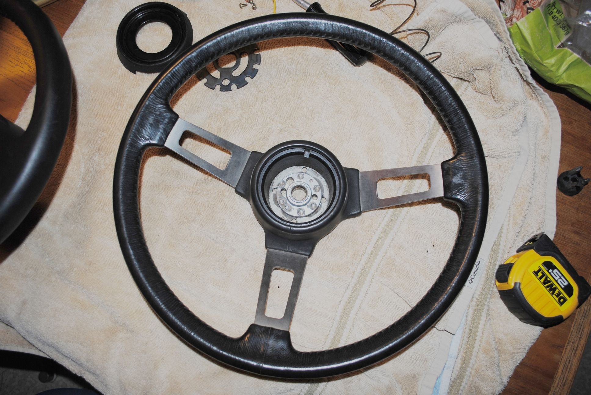

It's 1" larger in diameter than stock at 15.25" across the outside and the rim is thinner, which I don't like, so at some point I'll give it a real leather wrap in the exact same style that it's molded of rubber to simulate. It's a pretty impressive casting, actually.
The installation is simple, save for the horn wiring. This wheel doesn't have the telescoping functionality of the stocker and thus lacks the same horn infrastructure. Fortunately, the plastic base of the horn button spider, which sits against the back of the wheel, just happens to have a raised lip that is exactly the right diameter to seat the end of the stock Corvette spring, which is used both to preload the telescoping wheel and carry the horn signal up to the horn button. All I need to do is drill a small hole in the plastic base for the poiny bit of the spring to pass through to the front side and then I can attach a wire to that in some manner and connect it to the horn button.
The mounting of the stock horn button will require the most work. I'll need to fashion a plate that sits in the natural lip molded into the front pad of the steering wheel and features the same four notches that the horn cover presses into. This will then need to be grounded to the column. I think I'm going to use two bolts running into the threaded holes of the wheel hub (used for pulling the wheel) to attach my adapter plate positively so that will give plenty of accommodation for grounding.

I got the wheel installed in the car and all seems well. I have yet to fabricate the horn button mounting plate but I got bigger issues at the moment.
I've been worried that a three spoke sport wheel (I've been contemplating a Momo Prototipo for a while) would obscure the view of the gauges but I was happy to find that is not the case at all.
