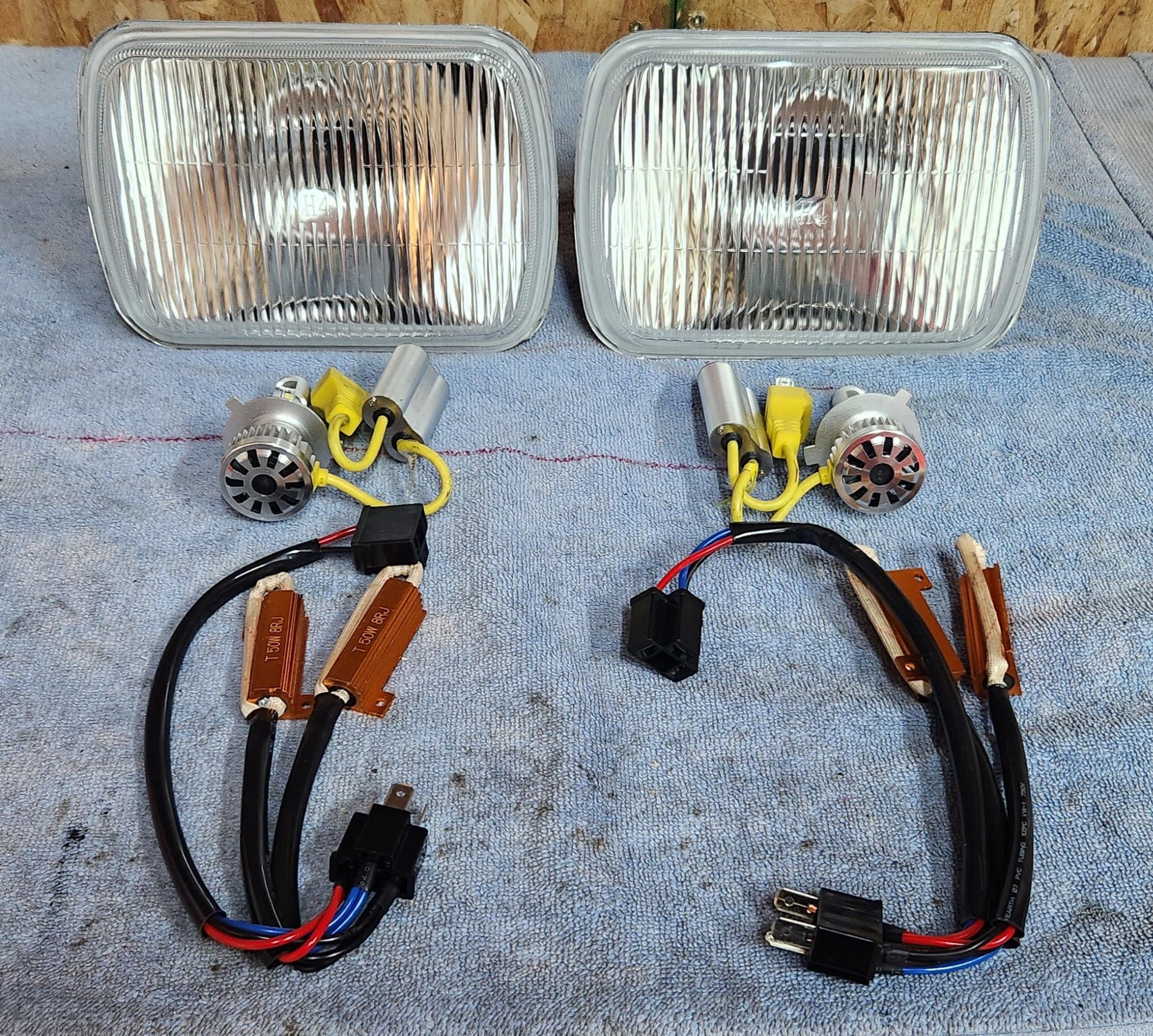

@LB66383 I'm experiencing symptoms identical to your.
My setup is from https://www.headlightexperts.com/ Ordered the lights December past >>> https://www.headlightexperts.com/h60...conversion-kit
Thought i'd be a wise guy and ordered the recommended "warning canceller capacitors" integral wit the LED bulb. Had hi/lo beams for the first few flicks and then "stuck" on low.
Contacted tech support, wanted to return product since i was stuck on low *and* as the joint where the lens meets reflector is not as wide as a Wagner Halogen sealed beam, so without someting to takew up the space, rattles loose in the bucket. I was told No Return on used parts and to order "resistors/decoders >>> https://www.headlightexperts.com/lig...stors-decoders.
Did a little research on our wonderful site, found threads of similar experience, causes for a variety of symptoms and suggestions to fix. Eyes being glazed over by disgust, after being told to order more, i forgot what i read.
As you can see in the attached picture of everything needed to fire up LED headlights from the experts, it's a lot of stuff to figure out how to fasten down in the limited space where ouor headights turn their beloved and spectacular 180' appearing and disappearing acts.
Tech support at Headlight Experts communicated in 3-5 word phrases with me and told me i could contact "Robert" to discuss my concerns. Which i have not done yet, but plan to do so, so that i have some idea of whatto exprct should i decide to try installing 10 pounds of parts in a 2 pound bag.
So, this isn't a lot of what you asked for, i've tried to make it entertaining. But since we have the same symptoms I'm sharing with you what experts told me will fix the problem.
Perhaps some very knowledgeable folks on the site will read your thread to help us better understand what can be done so our car's electrical system gives us hi/lo beams.

Looking at the pic you uploaded I'm assuming the yellow plug is the third connector for the bulb? The silver one has two plugs and the yellow fits next to it? If true the resistor pack you already have in the pic will probably work.
