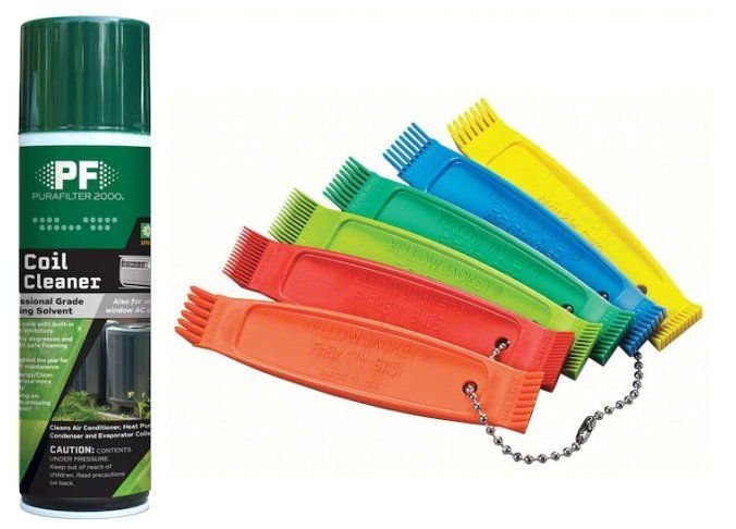

I cleaned in place. There are HVAC tools like a fin straightener and spray foam coil cleaner that helped. Then a water hose and compressed air . The finish used a bright flashlight and my wife's hand held mirror to look through the fins and verify all clear (hope she doesn't find out).
