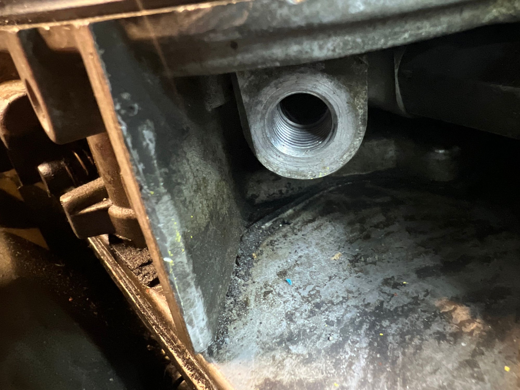

Need to find out the size of this hole on the injector for the main line so I can find a barb fuel fitting to put in it instead of original fitting

I cannot find the original fitting and the main line does not have a nut and I don’t want to dismantle everything to put a new main line. I want to put a barb and put a rubber hose between the main line and the barb for now until I have more room to work on the car. My goal is to get it running for now and then eventually when I have the money fix the little things

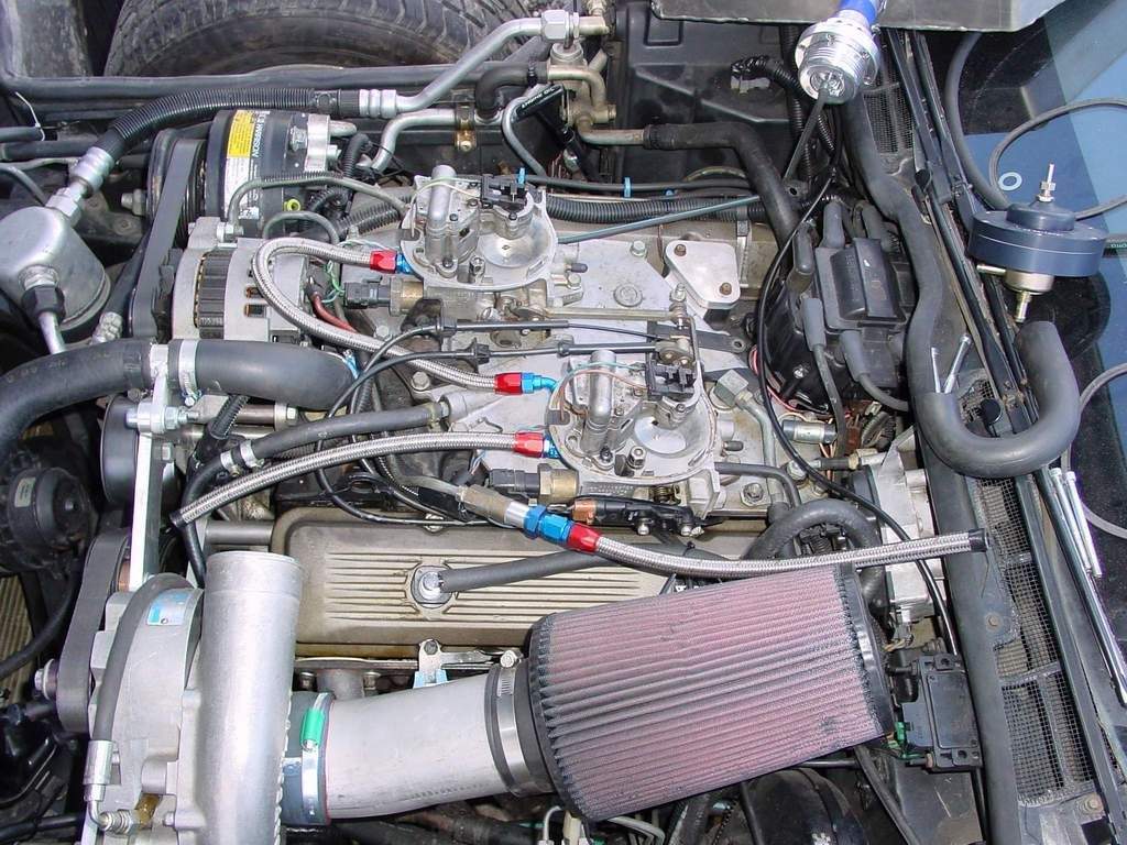

EARL's part #991945 12mmx1.25 to AN6 ( Carburetor Adapter Solex, Dellorto, Mikuni )
https://www.summitracing.com/parts/e...DnBpvibWyjtqer
https://www.joby.se/corvette/mods/2001-0X09_fuel/

will this fit on the car’s original injectors?

Any truck tbi unit will have what you need, you'll have to use a Saginaw flare though.
The thread is 12mmx1.25 ( outer thread diameter is 12 mm and the pitch is 1.25 mm. )
That is the tread on the TBI unit.
