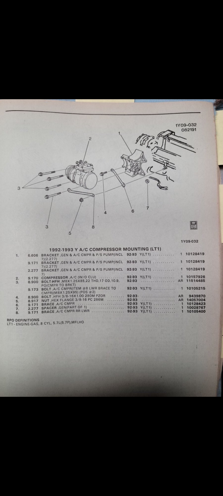

Asking for help here, My son has added ARH to his 1994 corvette , He did not listen to my picture taking advice, I must say though as an amateur mechanic he has done very well. Well he has no Idea where the air compressor brackets go, we / I cannot not find any information on this There a 3 tube brackets missing their homes ,(I dont think they will all work if any with the headers I think they went to the stock exhaust manifolds) but I cant retrofit anything I have no clue where they went and cant find anything on the internet for a diagram. Can someone post a pictures of these bracket locations or a diagram, or has anyone installed American racing headers (long ) that has fitted brackets for the compressor ?

They may need a standoff/spacer and longer bolt if it was attached to the old exhaust manifold.

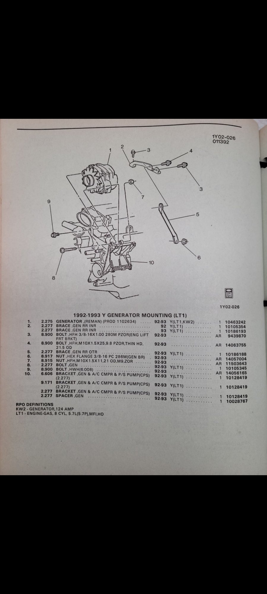

I realize this is for a '93, but I would think your '94 would be the same! Click on pics to zoom in! And Dave gave good advice, you may need to fabricate some hardware/source some bolts...you may need to compare manifold and header flange thicknesses and design and make it work, hopefully it all bolts to the main bracket on the front of the engine and nothing to the exhaust...but not sure! Good luck, you'll figure it out👍

Thank you, I wonder where the other 2 braces go there are 3 of these , But very helpful alternator I see the twist on the brace( 1st picture, part #5 ) ,the other 2 do not have that twist so this helps .. 2 more to go(for air compressor I believe) ! !

Same as before, for '92-'93, but hopefully the same👍
