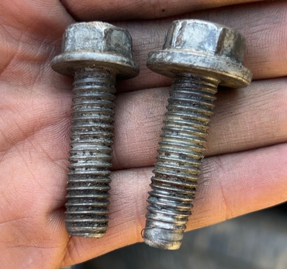

got it off. Turns out that removing the bolts from the exhaust manifold so early was not a good idea and was putting pressure on the bolt(rookie move).At least I think- putting two back on each side let me turn the bolt very slowly with all my body weight and more on a wrench. Certainly someone put the wrong bolt in but to my knowledge no one should have touched that stuff ever… makes me worried about the final bolt that even the impact can’t break loose :v
Normal bolt on left and the 15mm on right. Definitely doesn’t belong there.
