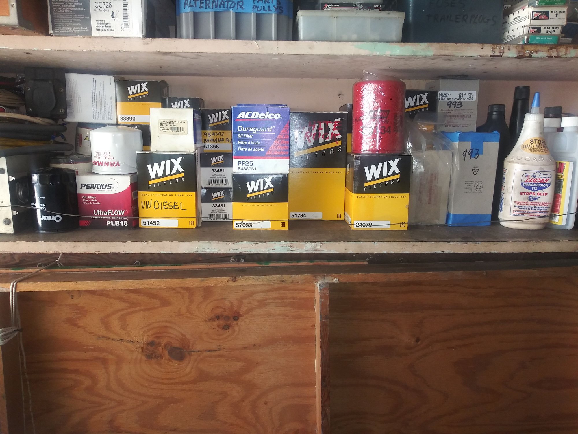

My 92 uses Mobil-1 10W30 High Mileage, The 85 uses Castrol GTX 10W-30 which is what has always gone in it except a couple of intervals with the 30W Delo. The 7.3 Powerstroke gets 15W-40 Delo like it has since new in 99. My ski boat uses either 20W-50 GTX or Delo 400 30W. I don't remember, I change it every 5 years, and it doesn't have cats. My daily POS S10 with 390k miles on it is to the point I don't care about it anymore. I put whatever odd oil I have on the shelf from client projects in it. (In the pic below there is a "Super Tech" 30 diesel oil. It cost $12 a gallon from Walmart Online. It is for the S10, because its cheap, and I don't care about this engine.)
I hear you on trying to minimize oil types. For myself, my cars are so seldom driven that change intervals are in years. So I just purchase the specific type/brand I need, when I need it. But I do keep some oil on the shelf. Cheers.
Oil filters, too. Some of these are for the marine diesels I service.
Oil filters, too. Some of these are for the marine diesels I service, but many are for my vehicles.
