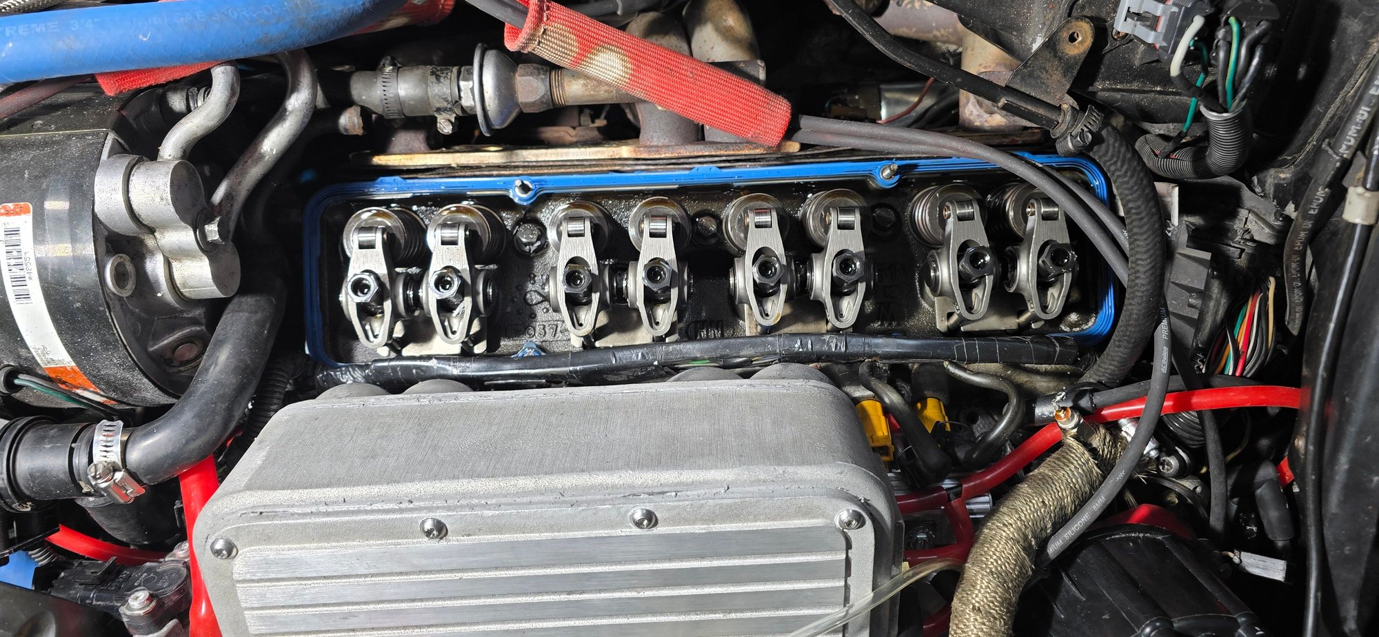

Some debris ontop of cylinder 6
Different angle
Different angle
Vacuumed the spark plug hole and it got the larger stuff.  Piston still doesn't want to travel to its furthest point.
Valves appear to be fine, from above and below.  I looked at them in the scope as well.
