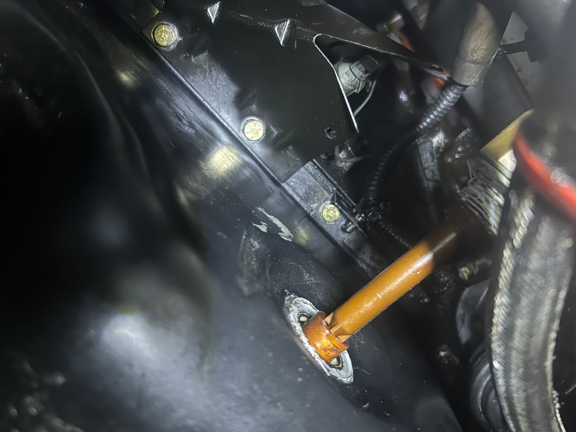

Hello everyone hope all is well I recently changed the oil pan gasket and timing cover gasket plus seals and well I’m having trouble putting in that sensor I’m thinking of alternatives like cutting it in half to plug the hole in the oil pan then maybe with tuner pro figure out a way to not get the low oil level light. Is that an alternative because I’m not sure what’s not letting the sensor go into. Also the oil dip stick is now not fully going in thoughts on that?

Also can’t see anything with the horrible picture provided. Got to help us help you.

I mean it's hard to take a picture under there I was wearing head lamp and flash on my phone and it clearly shows the sensor not going in there that's my current problem right now but it's not end of world I'll just plug it. Perhaps next oil change I could try a different sensor even though this one should just simply slide in.

Well the problem I'm having when reinstalling the sensor Dan is it's not going in smoothly I do not wish to just jam it in there in fear that the sensor will break inside and I'd have to drop oil pan again when I already tighten it down and put silicone on the edges to prevent oil leaks.

Probe inward with a skinny screwdriver and see if you can determine the 'elevation' of the obstruction. See if it can be 'levered' upwards with the screwdriver, and if it springs back down. The windage baffle may have cracked and broken at one or more mounting positions, moved downward and is now obstructing the sensor that is supposed to be just below the baffle. My 92's baffle was cracked in 3 of the 5 mounting positions. (I TIG welded reinforcements on all the positions.) This condition may be affecting the dipstick as well.
When I replaced the pan gasket on my 92 I had to gently bend the dipstick tube outward to be able to get the gasket between the tube and the main cap. I bent the tube back and installed the baffle. I double-checked that the dip stick still went in before I put the pan back on. Did you?
The LOW OIL light is controlled by the CCM. There are a series of conditions and time intervals associated with monitoring the level sensor. IIRC, the switch is normally closed. So an open circuit triggers LOW OIL. If you cut off the sensor, jump the two wires together to avoid "LOW OIL" annunciations.
C4Industries' picture is typical of the baffle, but that is not an LT1/4 because the engine pictured does not have 4-bolt mains. The LT1/4 do. The baffle mounting hardware is different too.
