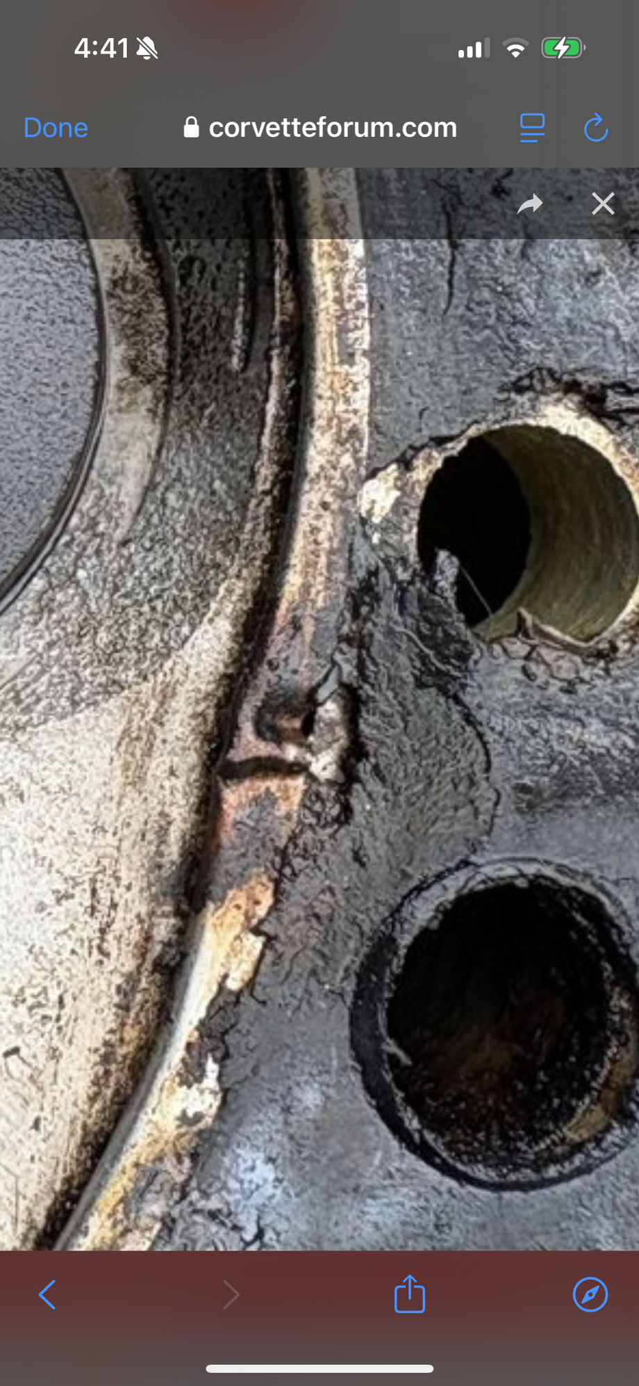

Default Heads off
so I got the head off and #7 was clearly being steam cleaned. The ring on the right side is crimped. I’m thinking I may not be the first one into this engine and the prior gasket was defective and installed as such. I have trouble picturing a stock engine doing that. No clear damage to the heads but will send them out.
Old Apr 22, 2025 | 03:06 PM
marshallnoise's Avatar
marshallnoise
Joined: Sep 2024
Posts: 526
Likes: 114
Yeah, there aren't many smoking guns there. But it could be simply that the gasket material heat cycled enough and then the cylinder pressure found the weakest point.
Old Apr 22, 2025 | 04:48 PM
GlennsFirstV's Avatar
GlennsFirstV
7th Gear
Joined: Apr 2025
Posts: 7
I’m looking at this part of the steel ring, that crimp appears to be the failure point. I suspect it was assembled that way.
Old Apr 22, 2025 | 05:31 PM
gtFOOTw's Avatar
gtFOOTw
Joined: Mar 2022
Posts: 121
Likes: 61
Looks like a lot more obvious failure point than mine, but I still ended up with a crankcase full of coolant and a steam cloud out the exhaust.
