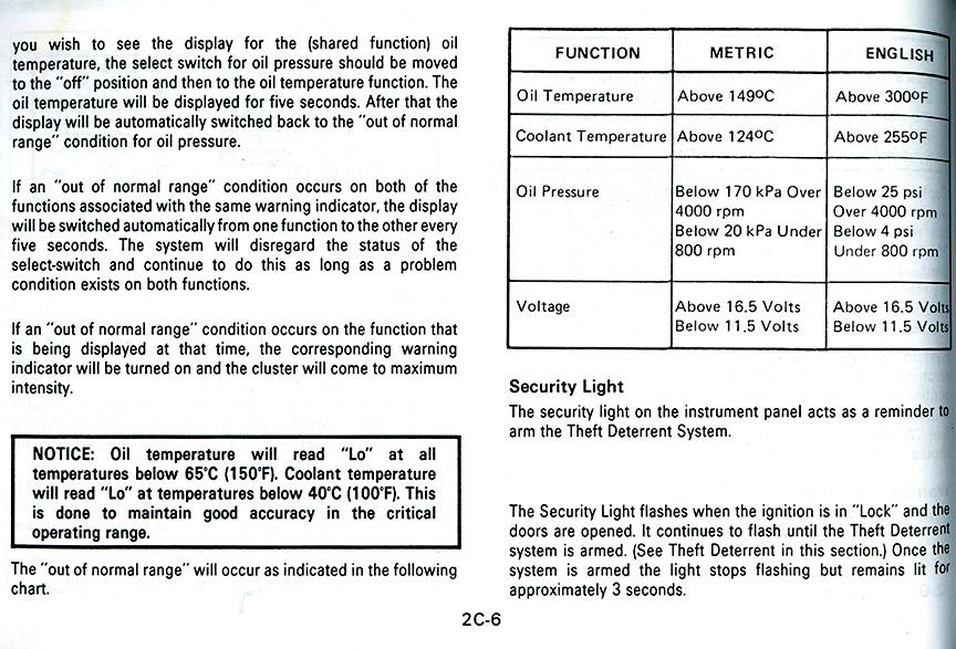

I'm a little confused. The oil pressure gauge should never say "Lo". Oil temperature will say Lo until I believe about 110 F. So will Coolant temperature.
Was the ENG/MET switch in Metric? An oil pressure reading of "540" could be 540 Kpa which is 78psi. << Seems about right for cold oil.
The hissing after shutdown: If the A/C system was operating at the time of engine shut down, it will hiss until pressure equalizes across the orifice tube. Usually, the hiss is even (not every 20 seconds), and lasts about 15-20 seconds, depending.... << So probably not the A/C, but that's all I've got.
I don't think there is anything wrong to prevent you from driving it. Drive it. Watch the temperatures and pressures. Be sure the switch is in ENG[lish]. It's probably ok.

I may b mistaken on the low, that may be the oil temp that said this. It's not switched to metric. That was then1st thing I checked. To be completely honest I rarely had it set to read pressure. Almost always temp. Idk why it's just where it usually is. I ofc flip it to check the pressure from time to time, and I know for a fact it's never read that. I'm gonna check the relieve valve, replace it along with the sensor, and use a manual gauge to check it as well. My biggest worry was it sitting longer than normal. I had a truck that sat for a year when I was younger end up needing a complete rebuild due to water ports rusting up. So I'm a bitnover cautious maybe

Caution, this is from my 87 and may be different for 89 but I dont think so.
There is a warning light next to the readout, it is square, was it on. There is a chance your are seeing a connector off somewhere and it may even be the oil temp, on my 87 the oil temp sensor is on the block near the oil filter. The reason you may be seeing the oil temp when the switch is in oil pressure is the cluster forces the out of range information onto the display reguardless of switch position. For instance, if the oil temp is out of tolerence the red light should come on and the display automatically shows oil temp no matter where the switch is. In order to display oil pressure in that condition, the switch has to be moved to the off position then to oil pressure, it will display pressure for 5 seconds before automatically being forced to display the faulty oil temp.
