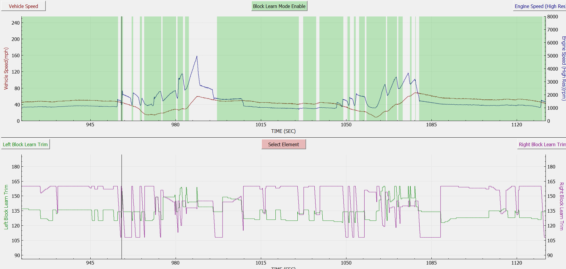

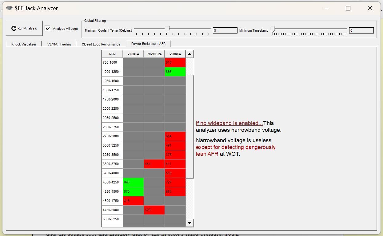

Okay, I did a datalog with $EEHack. I went with FlashHack since I am using an old laptop, and if I disconnect during flash at any time, they offered a program that can restore everything and avoid bricking my PCM most of the time...
Besides that, here is the data I logged:
I don't know much about what the data is telling me, but I assume the red on my AFR is no good. While driving, during the stumbling events, I would see that my Right Bank BLM would dip into the red. This also occurred with engine breaking.

I have also noticed that my right bank BLM is all over the place. When the throttle is at 0% it sits steady at 160, which I thought the goal was to have this at 128 +/- 15. Then as I drive it pretty much sits at 160, with some dips down to 108.
The left bank seems to keep itself around 128 fairly well.
If the BLM is sitting at 160, I think that means a lean condition, right?
