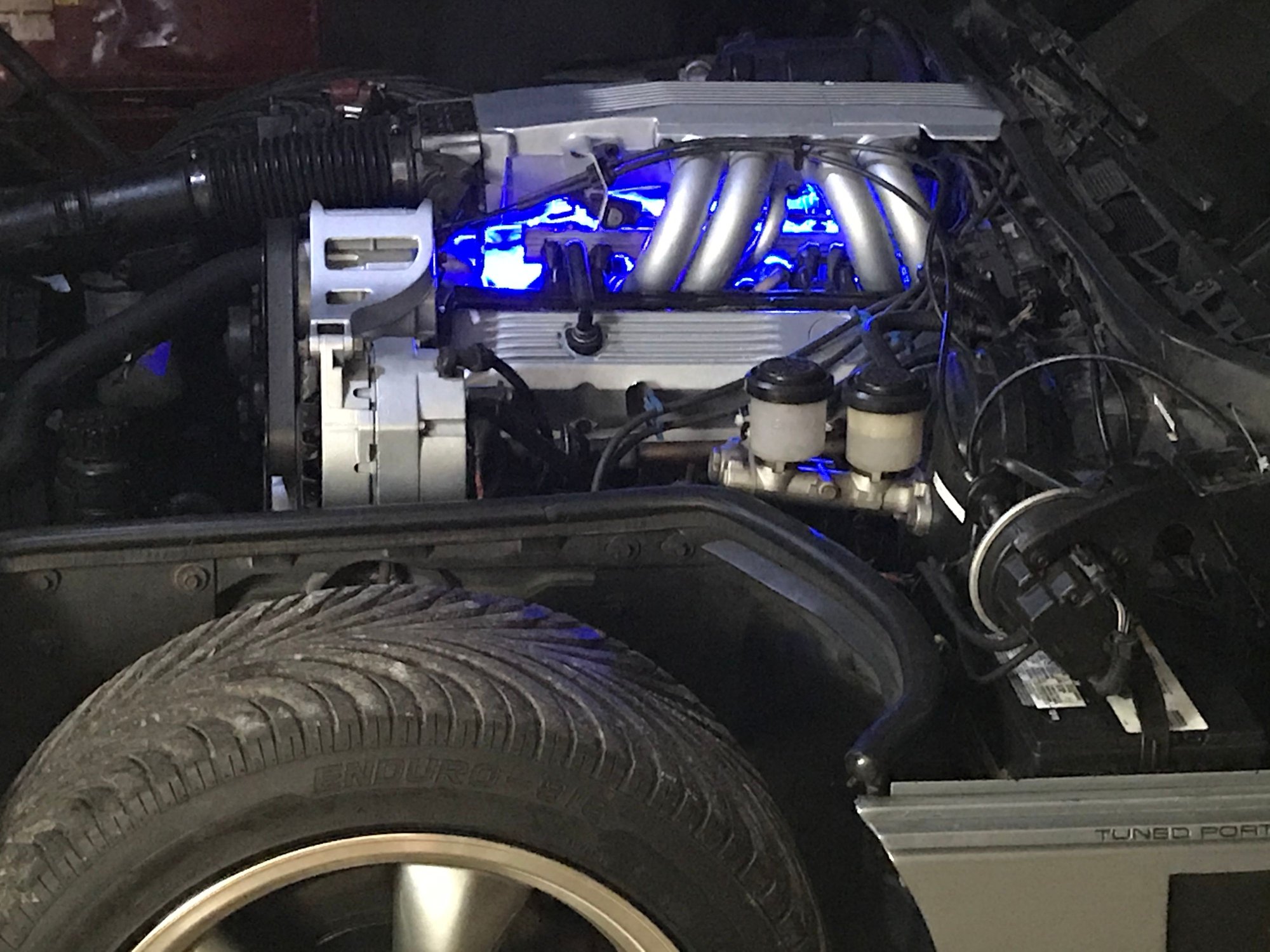

I have an 85 Z-51 4+3 and I'm keeping mine mostly stock. I like the "museum piece" aspect of this car. Its intake manifold and fuel delivery system were the grandfathers of the LS engine's fuel system. Plus, the fact that it was run via a computer built in the vintage of a Commodore 64 make it a very unique engine. I featured it at shows by putting a line of blue LED's under the plenum, that draws plenty of double-takes.
But that"s just me.
