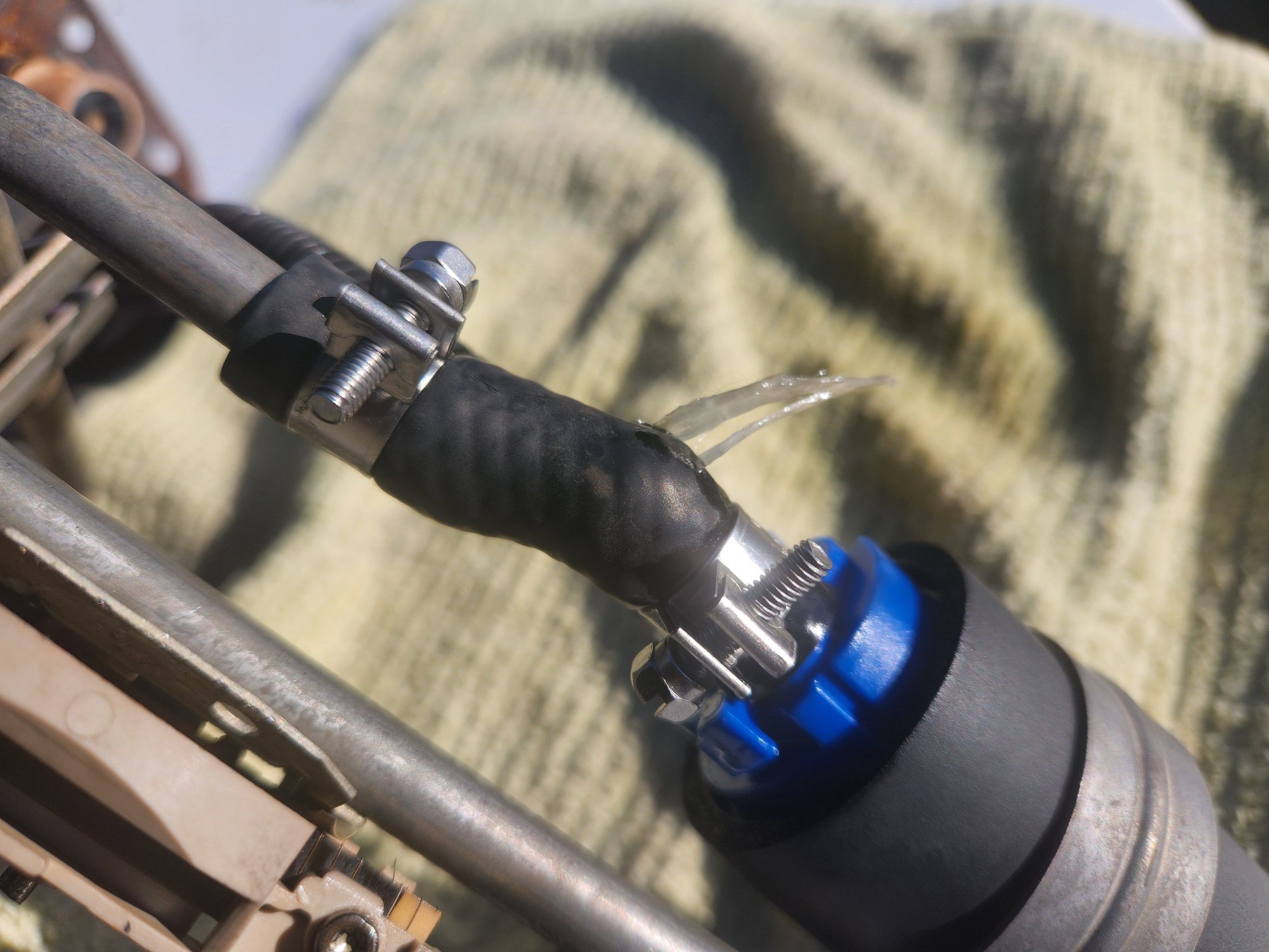

Got back into town yesterday and was finally able to check the pressure. 3 PSI when the key is first turned on, then instantly drops to 0 PSI. About 6 PSI when cranked, runs badly for a few seconds, then dies and drops immediately to zero. It does make good oil pressure. I'm going to pull the pump tonight.

Wellllll, mystery solved. As I was taking it apart, I could see that I wasn't the first person to tear into it. When I slid the assembly out I could see that I was looking at a brand new pump..... then I saw this... a split hose, caused by misalignment.

This one is looks exactly like Delphi that I just bought. But, it didn't fit properly, I think that stress caused the fuel line to split so I installed the Delphi. I fit perfectly and was snug. Never buy those $30 Amazon pumps....
