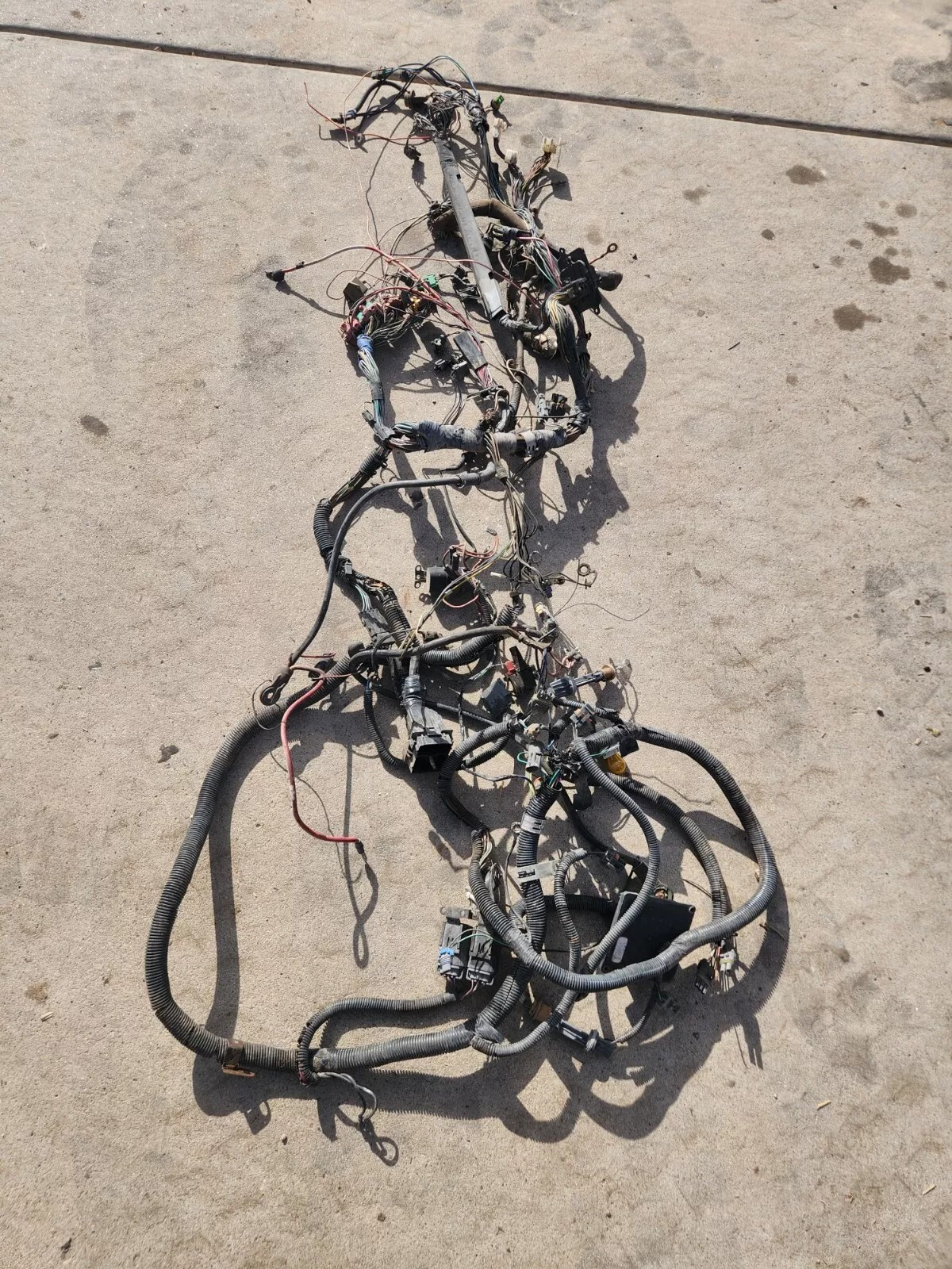

I haven't had to do that yet on my 84 Corvette, because everything is solid there... but on most 80s GM vehicles, there are usually two, or (in early 90s) one large harness that connects to the car's computer (in your case, I think it's in the engine compartment). This harness is invariably connected and directly wired to other things in the car, so that's why I say that removing things from the harness has to be done carefully. I am not 100% sure, but I know some things like air conditioning sometimes have a pass-through that goes through the ECM (to either increase or decrease fuel, or to compensate for the fan being on, etc.). But the harness that your ECM harness connects to... somewhere down the line will also be wrapped up with other harnesses. This is done because the "engine compartment harness" is usually installed as one complete wiring harness that comes with the engine, and usually has several leads that go to a bunch of things... usually a large bulk connector at the firewall, and the ECM harness (which in your case I think is in the engine compartment).
So, what I'm saying is... it all comes wrapped up and tied into one large harness.
You want to go through your entire engine, affix a label to every wire that's connected to every harness on your engine. Like I mentioned... some of the wires go to the ECM, others go through the bulk connector to the gauge cluster because the ECM doesn't need it, or it's redundant... but either way, they'll likely be taped / tied / connected somehow, if not by tape and wire loom, but then sometimes by sharing a grounding cable, etc.
As you disconnect things off the engine and label them, you'll want to carefully remove it from being snaked around the engine. Once you have ALL cables removed from the motor, you then want to disconnect everywhere it's connected... which is likely at least 1 large bulk connector at the firewall, and the ECM connector.
The entire harness should come out as one entire mess of wires.
This is where you need to be careful. You'll want to look through the factory service manual and see what you want to keep from the factory ECM harness... which ISN'T already replicated in the new harness. For example... switched power, or A/C on indicator, etc... there should be at least two or three.
Remove every piece of black electrical tape, and all the plastic wire loom covers... and then you can separate everything from the bulk connector, to the ECM harness... and then... take your new engine wiring harness, and overlay it onto your old harness... and you can begin removing the old parts of your original wiring harness you don't need. Never remove a ground... because you can never have too many of those.
Like you, I dislike how the wiring harnesses are often put together on factory cars. The reason they do this is because the wiring harness is pre-installed on the engine and transmission for ease of installation, not specifically for looks or ease of maintenance. That means that often times, wires are routed through the engine in the weirdest places you can possibly imagine. I had one car where the A/C clutch and pressure sensor wires went from the firewall, to the back of the engine, wrapped around the side of the motor, installed in a plastic bracket in FRONT of the motor between the harmonic balancer and another accessor, and then routed to the A/C compressor where it was located on the totally opposite side.
Whenever I restore a car, even if I'm doing a factory rebuild, I always end up re-routing some of the wires because GM puts them in sometimes the least desireable place.
Hopefully that all made sense.
But just to reiterate... most gauges on the 80s GM vehicles are powered and fed through sensors that are redundant and not connected at all to the ECM... but they are still wound up and taped together in the engine harness with the ECM's harness. So doing it right here will save you a lot of time and headache... because you don't want to have a really nice new wiring harness for your Holley system, all ready to go, and then realize that you have to run two bulls**t wires from the bulk connector at the firewall, up and over your engine... because it'll stand out, look bad, and not be reliable when they should be wound up with the new harness.

Ok, I'm not really explaining myself well. The "harness" you're talking about is not just an "ECM" harness... it's a huge harness that includes a bunch of other stuff, in addition to the ECM harness, that's all wrapped up into it. You're focusing on just what you're seeing at the ECM... which is a two big connectors that sit side by side - see this eBay auction: https://www.ebay.com/itm/126933372916?
But again... that's not it... the "entire harness" includes everything on the engine, in the engine bay, etc. You keep referring to it as an "ECM harness" but it's really an "engine harness."
Take a look at this L98 1990 5-Speed Corvette "engine" harness: https://www.ebay.com/itm/156563928317
I don't want to scare you... but this is a 5-Speed... which has at least one less connector than an automatic. In this tangled mess of wires... you've got everything from your A/C wires, to all the wires that power your gauges, etc. Not trying to be mean, but really want to emphasize that you're kind of under the impression that you can just swap out the ECM, and anything on the engine goes away. Everything in the engine bay is connected... just looking at this harness, I see several bulkhead connectors (which provide information to your gauge cluster, and everything else), I see A/C compressor wires, I see a power bulkhead connector, along with the power cables going back and forth to the alternator, all the sensors which power the gauges. Like for example... the oil temperature sensor. I know that on your engine, it probably has like 3 leads... one is ground, one goes to the gauge, and one goes to the ECM ... presumably, the one going to the ECM is probably to help with cold start and fuel compensation until the motor warms up (just a guess). On that one sensor... your ECM harness is now connected to the gauge harness, which is connected to the engine harness, which is connected to the bulkhead connector. So you can't just rip it all out, otherwise your gauges won't work. SO... in my example, you label everything as you take it off (using the factory service manual) and then remove the entire harness from the engine bay... and THEN you determine what wires you remove and which ones you don't ... you determine this by eliminating the wires from the original engine harness that are redundant to the new wiring harness that's included with your Holley kit.
All the other wires will go where they go... meaning, they still go through the bulk connector to your harness (oil temp sensor, oil pressure sensor, temperature sensor, etc.).
But I want to make a comment, I just looked up the Holley Sniper 2 EFI... IHBD is right... this is a kit that's made for a carburetor conversion. Man... if I could be honest with you, you absolutely do not want this kit. He's correct, it does not include timing... your engine is this one, right?
The engine is already very well designed, and you're not going to be gaining any power by going with that system. If you are dead-set on replacing the ECM with a newer system, you really should consider something like the MegaSquirt, or even the FAST EZ-EFI 2.0, which does control ignition timing.
The Holley Sniper 2 EFI would be something I would get for my Olds 455 Big Block... not for an LT1 motor...

Originally Posted by KdnJenks070502
Even with the appropriate intake manifold conversion?
I'm basing most of my choices off of this forum post. It's a long one, but the user is considered a highly reputable certified tech.
https://www.digitalcorvettes.com/thr...native.297044/
To be fair... I'm not really in agreement with the decision he made. There are many other paths he could have gone down. It seems he had real issues, and just wanted something that drives and wasn't too concerned about performance.
1. Got it, label as I go about removing things so that I'm aware of where they connect to afterwards, then once I've removed each connector and harness, I can go through with the FSM and determine what stays and what goes from the full Engine Harness. What I'm curious about is how to retain functionality of some of these things. Take the Air Conditioning for example. I assume I'll need to retain the stock ECM, unless there is another module in the vehicle which specifically controls the AC system. Same goes for ABS, etc. etc. I suppose that would be answered in my FSM.
Correct... so, taking Air Conditioning... in this case, it's likely not necessary that the NEW aftermarket ECM know or even cares that you have A/C. In the old ECM, it likely had a lead that let the ECM know that A/C was engaged (clutch) and then it made a couple of small changes to compensate for the additional load. The new ECM will probably learn to compensate when it sees "effective changes" that occur anyway, and it'll be almost indistinguishable. So, it's not really a big deal... but remember, again... you're still focused on the ECM and what the ECM does with respect to the harness. The harness has everything... it's part of the ECM harness, it's the "engine compartment harness." There are other wires that go from the dash to tell the A/C compressor clutch to engage... that wire is also going through the bulkhead and wrapped up with the harness that you're calling the "ECM harness." So there are a LOT of wires that will still go back and forth, that while independent of the ECM, are still wrapped up with the ECM's wiring harness.
2. Correct, that is the same engine I have. i haven't looked into the others, but what would you say is the difference? I mean, I simply went with the Holley Sniper because of its reported east of installation and other reviews. It looks (to me) that the FAST option is similar to the Holley, but without some of the ease of installation options like the PDM. The Megasquirt option seems like it still remains the Optispark, one thing I really would like not to do. What do you see about this that I'm not seeing that makes these so different?
I looked up what a PDM is, because that's not a common thing that most people do. It's a Power Distribution Module. I don't really see how that's really that helpful or useful for this application. The FAST EZ-EFI 2.0 does not really use a PDM, and doesn't need one. I don't think even in your configuration, you even need a PDM... and it's actually quite unnecessary.
Before I talk about the Fast EZ-EFI 2.0... let me explain the biggest problem here. You have the LT1 intake, runners, and configuration... which is relatively speaking, a highly sought-after design. It flows really well and is tuned for amazing mid-range power. You would effectively be replacing all of that with a somewhat generic "throttle body injection" configuration. I want to emphasize this so you understand... you'd be essentially installing a square bore TBI... which is not too different than what GM and Ford pickup trucks came with stock in the early 1980s. You'd be replacing a race-inspired high performance intake system, for a general use square-bore throttle body injection.
Now, the difference is that the EZ-EFI 2.0 system is designed specifically to upgrade older OBD1 style GM V8 engines with more modern engine management ... period. So, you keep your factory intake... keep the injectors, etc... and merely replace the computer and the engine harness. It connects to all the existing sensors on your motor with the actual GM connectors (that are already on the new harness) and you get a much more advanced "self-learning" engine. You can replace the OptiSpark with one of the many aftermarket replacement systems... you can even upgrade to DIS ignition... but you still need a cam and crank sensor.
Keep in mind, FAST also offers a "carb replacement" unit that does the same thing as the Holley Sniper EFI 2 system, but there's no reason why you'd want to use that... with the FAST EZ EFI 2.0, you can re-use all the (vastly superior) LT1 intake and hardware.
Does your car not run? I just wouldn't really be looking to this as an upgrade unless you had a real reason to. I'm upgrading my 87 Fiero SE / V6 with the FAST EZ EFI 2.0 system because I'm replacing the factory 2.8 with a modified 3.4 (9.7:1 compression pistons, ported cyl heads, etc...) and I want to be able to take advantage of the improved performance without having to go to a dyno or shop to have it dyno tuned. But if you have a stock running LT1 V8 that runs well... I would probably just leave it.
Wiring can be a really daunting thing if you're not very methodical about it. I actually believe rebuilding an engine is far easier than building a wiring harness for a modern engine.
