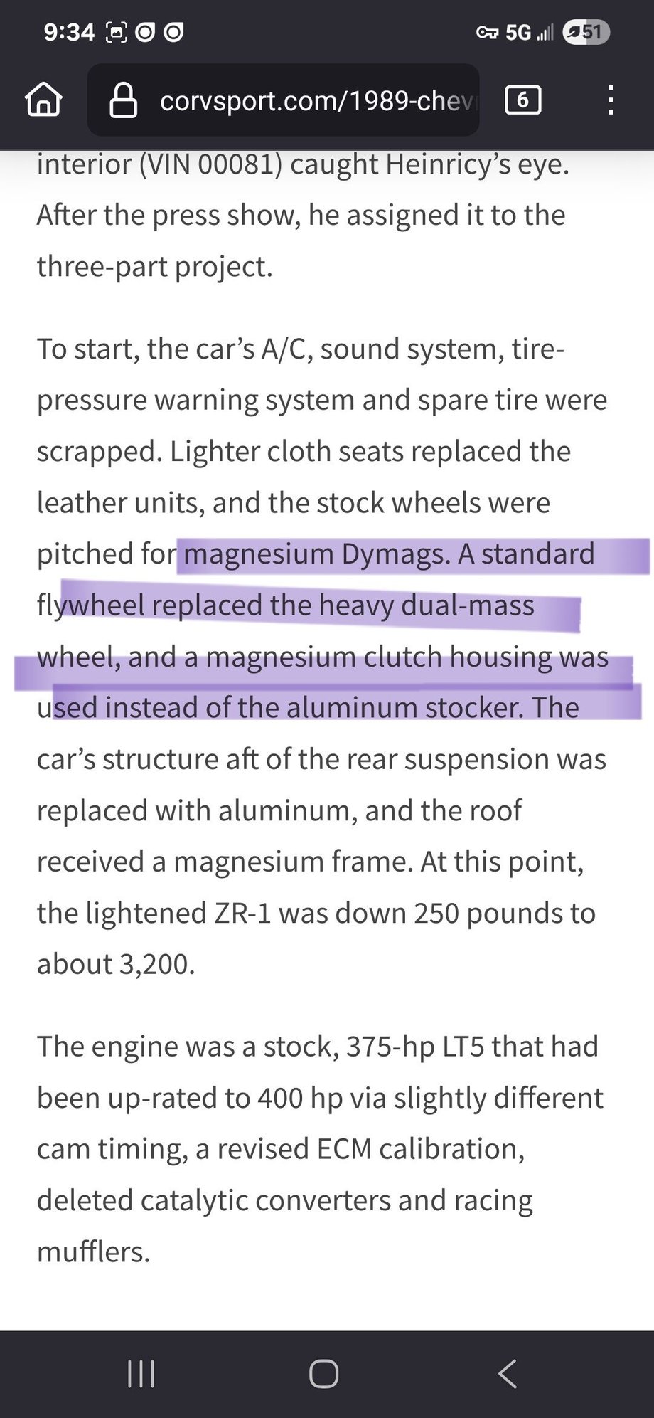

One of the 1st things to go on GM's performance builds for these cars, every time, was that flywheel. I can't find the quote right now, but Killebrew despised having to use these flywheels on the Challenge cars. Made shifting & rev-matching much slower. Apparently they held up well, just heavy. This was from an article on the Snake Skinner build:
