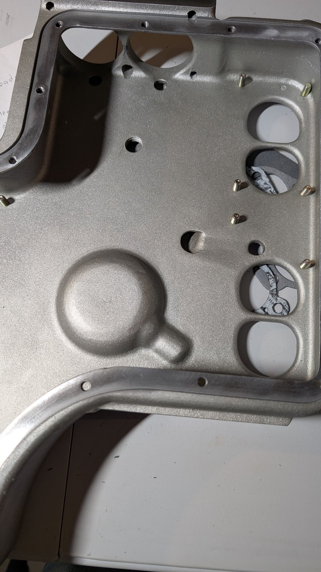

I bought a used superram a while back and am finally getting around to installing it. I didn't notice this before but I see in the plenum it looks like a previous owner modified or broke part of the egr routing. There should be a cap and pipe plug where the egr runner comes into the plenum if I'm not mistaken. I suppose with it gone, the exhaust still gets in there but I'm not sure what the best path forward is. I was planning on keeping egr but guess I can block it off if that's best. Thanks in advance for any advice.

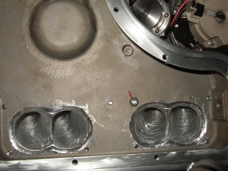

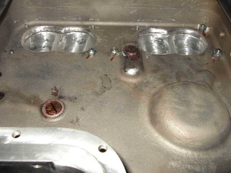

EGR can get a little extra mpg but blocking it is okay. The SR that I had I remember cutting a slot in the plugs and using locktite.
