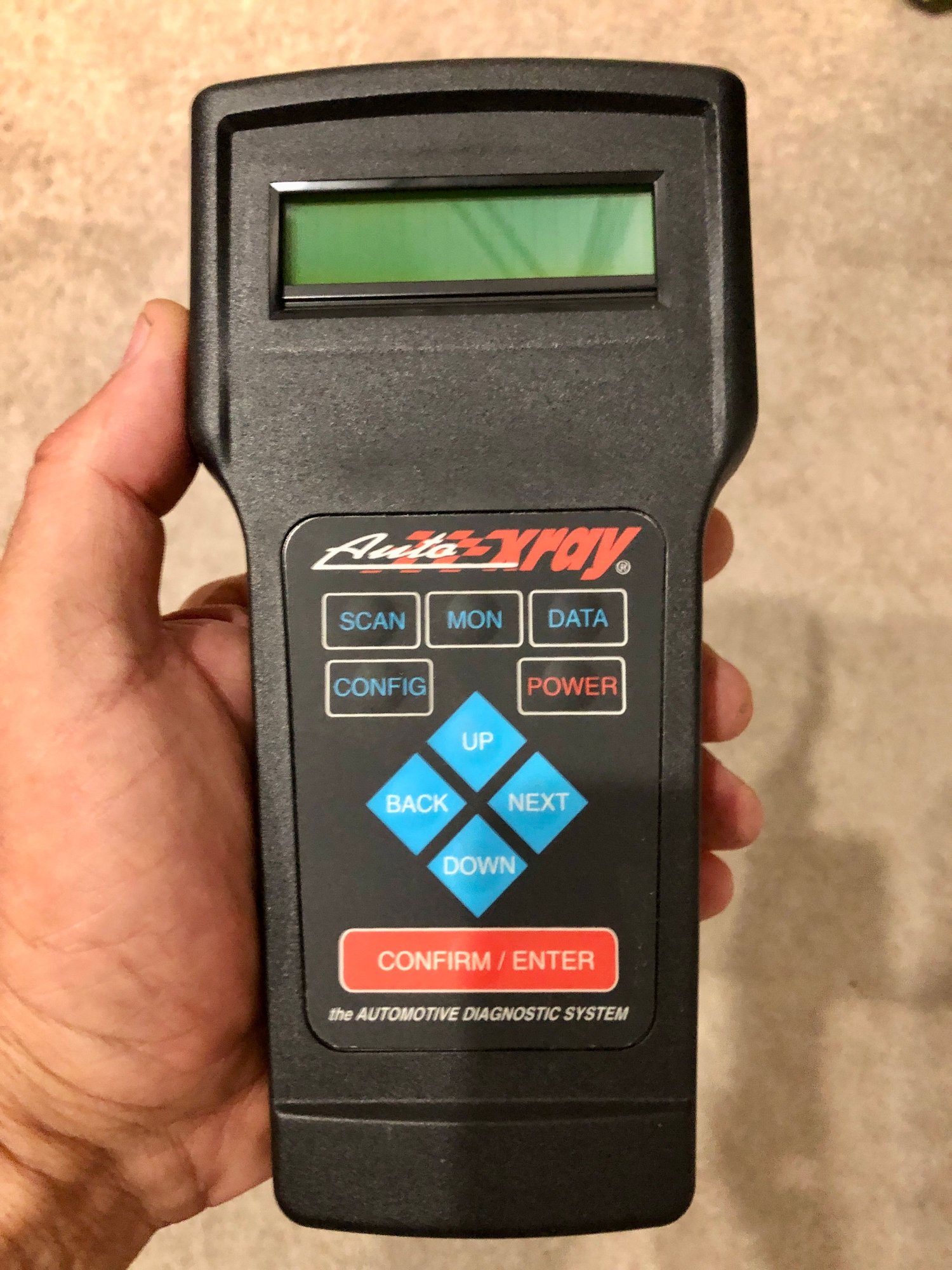

Is there anyone that can repair an old AutoXray scanner? I went to use mine and it seems to be dead. Will not light up.

change the batteries and check the batt terminals for corrosion.

Thanks. I did change the batteries and cleaned the contacts for them. Nothing.

I had one go out in a similar fashion - it was the display. I bought a similar display on eBay and bodged it in - it works now...

That's a nifty idea. How did you know it was the display?

Under certain oblique lighting conditions, I could just barely see the display. Totally unusable, though.

Mine, which is an Auto X-ray XP240, can monitor parameters with the engine running.
