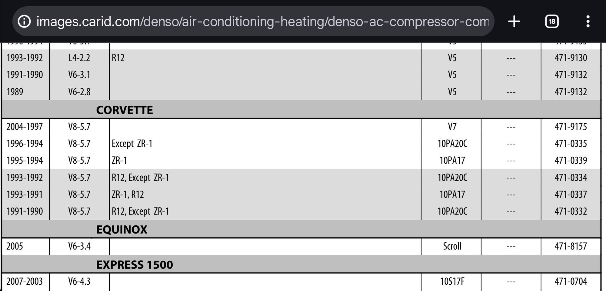

In doing some research, I found out the ZR1s use the 10PA17. I wonder if the larger compressor was used due to the greenhouse sized rear hatch, and the smaller one in the ZR1 due to a larger engine? If the ZR1 A/C worked well, then I'd assume it would be fine in my 89.
I think the length of the body is different for the two displacements. The distance between mounting centers will be different. The displacement is determined by the stroke of the pistons. Larger displacements have longer stroke, and thus longer center sections.
The ZR-1 has the same evaporator size as the 'base' car, but the air-flow through the lower 1/3 on the outlet side is obstructed by the relief put in the housing to clear the cam cover on the LT5. This 30-ish% reduction in air-flow reduces the heat transferred into the evaporator, and thus can utilize a smaller displacement compressor. The shorter compressor may have also been a consideration for packaging on the LT5. I have no idea if it was.
The ZR-1 also has the special "Solar" windshield with the laminated tinting to reduce the sun-load on the interior. OEM's have standard specifications for Air Conditioning performance. To meet these requirements, the ZR-1 received the Solar windshield because of the reduced cooling capacity of the A/C system. I've owned a ZR-1; I'm not so sure I would evaluate the A/C performance as "worked well".
In a CCOT A/C system, the larger the displacement, the better the refrigeration system performance at low engine speed in hot ambient conditions. Like at idle in stop and go traffic in July. At higher engine speeds, the clutch begins to cycle to maintain the desired evaporator pressure/temperature.
Stick with the 10PA20.
