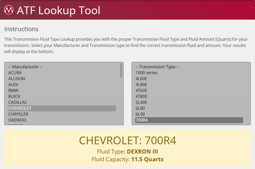

I've got a New Reman trans from Moveras ready to go in that I bought from AutoZone. My question is..
AutoZone is telling me to use Dexron VI, Moveras is telling me to use Dexron III and to not use Dexron VI. I'd really like to use a AC Delco fluid, but my local Chevy Dealer is telling me Dexron VI is what everything migrated to.

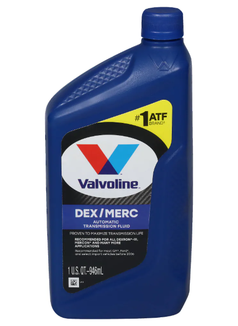

They can get an AC Delco Type 3 Fluid, but they and I aren't sure if its the same fluid type. I added a few quarts of the Dex/Merc from Valvoline in the old trans cause it was low.

Does anyone know if AC Delco Type III fluid is the same as Dexron III?? I don't think the Valvoline had anything to do with my trans failing, I really think it was bad prior to me buying it. I just want to be sure on the fluid.

Id follow the remanfactors suggestion.

I agree putting in with what they recommend. I've hear a couple times all Dexron's Migrated to VI. I'd like to stick with Dex III.

This is from Dextron. I bet you have seen it. Dan
What Is The Difference Between Dexron 3 and Dexron 6?
The main difference between Dexron 3 and Dexron 6 is that Dexron 6 is a synthetic fluid and Dexron 3 is not. Dexron 6 has more up to date fluid properties which allows for a longer fluid life and is much better at dealing with higher temperatures. Since Dexron 6 is backwards compatible, you can use it in Dexron 3 applications.
