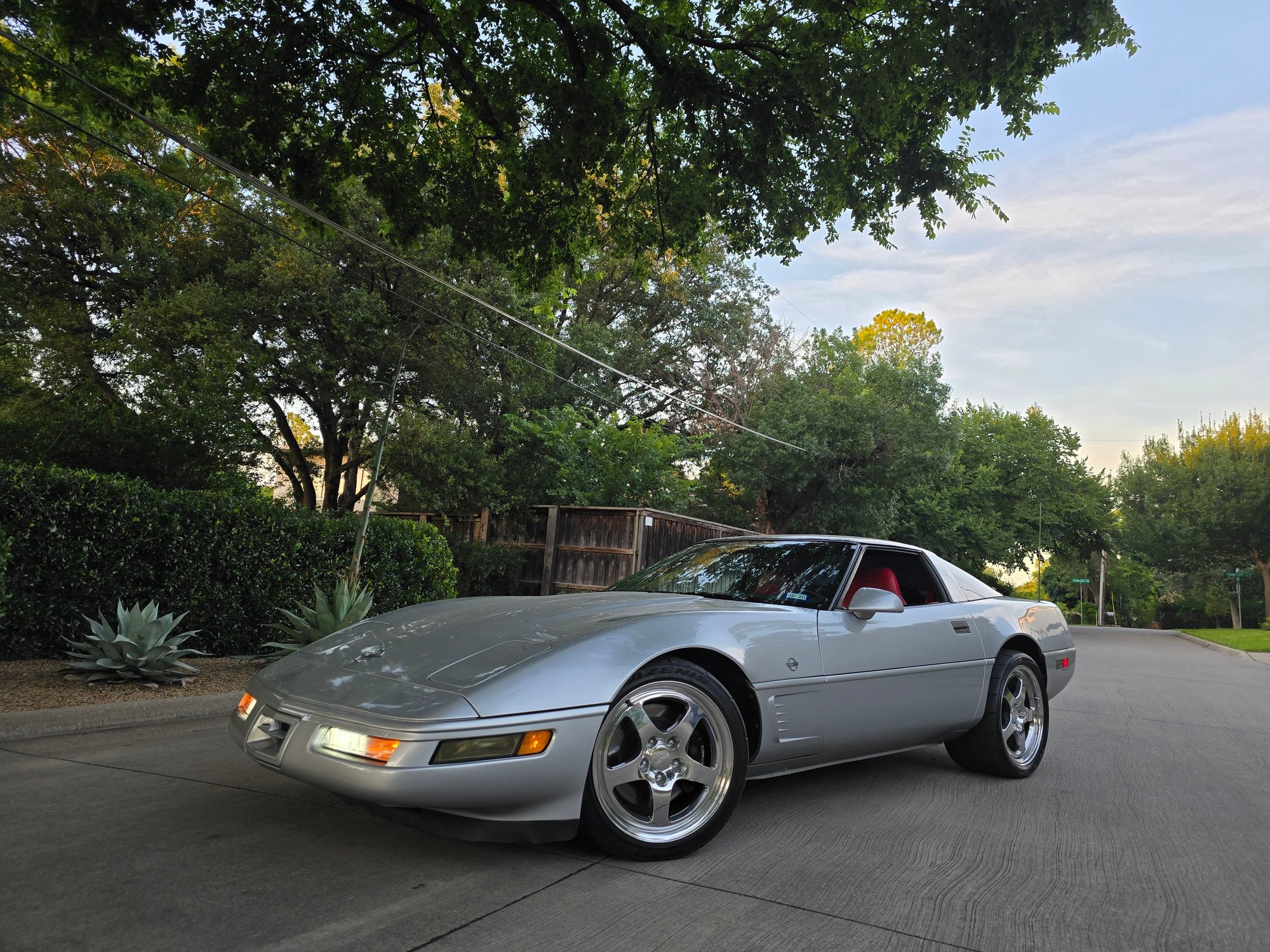

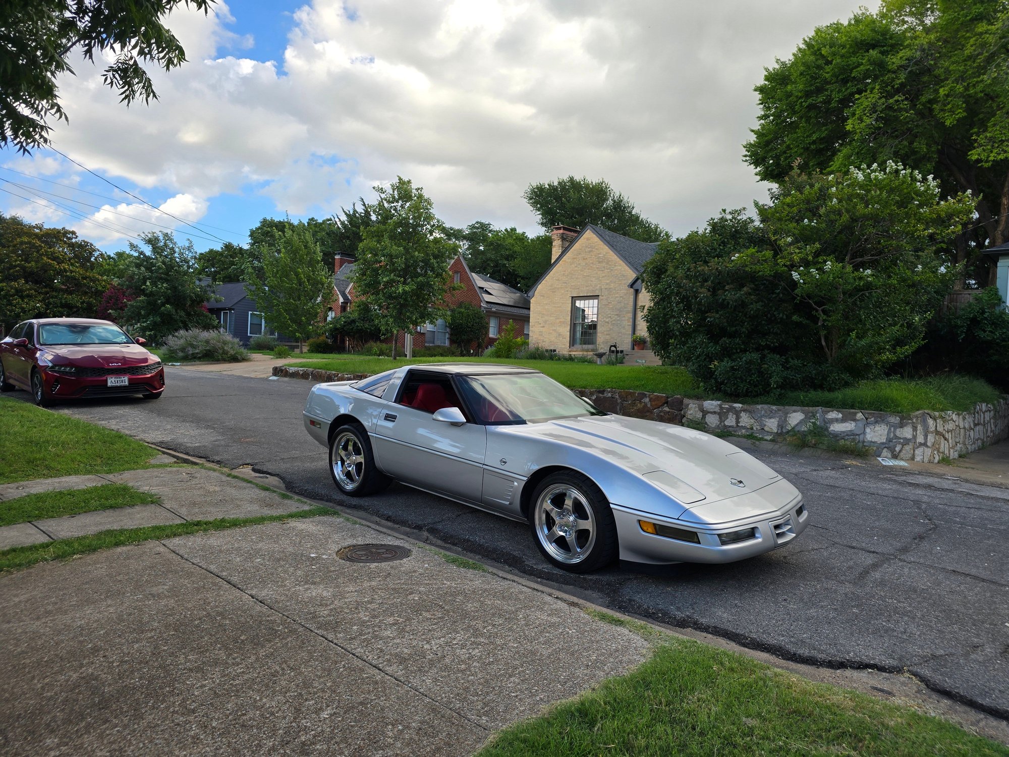

Glad you got it sorted! Beautiful CE you have there👍
