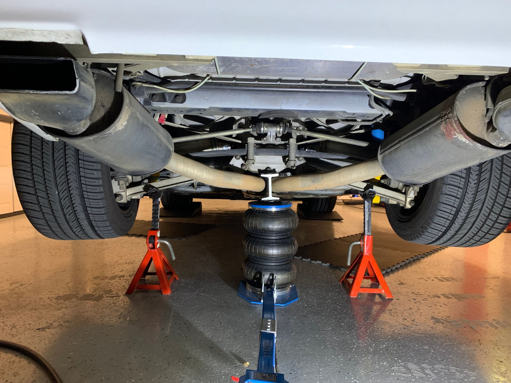

Originally Posted by CorvetteRules
There is no way you can jack the car off the ground with the rear suspension at normal load. You can put it on a dyno to do it and even thinking to try doing it on jack stands shows no sense>
Well, here it is...
Old Jul 12, 2025 | 10:27 PM
Elduderino's Avatar
Elduderino
Joined: May 2007
Posts: 306
Likes: 49
From: Florida
Better yet, this is far as I can get the geometry correct to run as normal as possible, And oh wow, it was horrible, sounded like the shaft waas coming aapart, seriously eefed. And before anyone asks, the drive shaft has two new u joints and a Sonex slip yoke... effed man just effed
Sure looks dangerous to me. How did you determine the suspension was at load height? I'd think it wouldn't give realistic test results since in normal driving the load would vary when actually going down the road.

Greetings all, thank you all for the comments and I certainly agree with everyone who says this was a crazy thing to do and that I’m an idiot. I am, but, as you can see the stands were as close to the center of the tire as possible, but inboard of the tire center line so the angle was not accurately at ride height unless there is a lift in the rear for whatever reason. In this configuration there is no load associated with the drivetrain other than rotating the mass of the wheels and tires. This works well and I was able to measure the speed that the car would go at idle in each gear, given a theoretical situation that supports the circumstances, but that’s irrelevant. Anyway, while accelerating in 6th gear (any other gear would be the same but I’m using 6th because it's the highest) I can induce a horrible vibration and clanking sound, as if several ½’’ nuts where being shaken in an empty paint can on one of those paint can shaking deals. It starts to raise hell at about 60 and smooths out at about 100, then putting it in neutral and shutting the engine off (to guarantee the fly wheel is not an influence) it started to go nuts at about 85 and got worse until about 75 when I thought it was going to leave the earth, then just settled down at about 65 and was sloth as normal. Any thoughts on this? I’m closer to coming up with a unified theory than to solve this problem, Dude.
