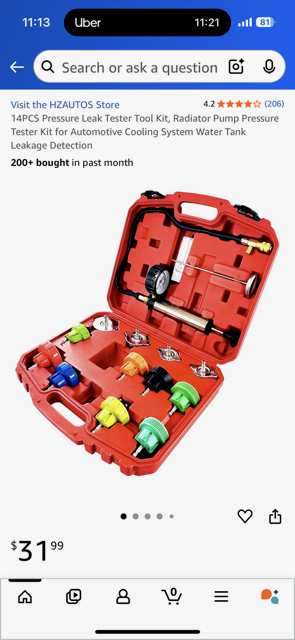

With any coolant issues, we should always do a leak check and cap check.
