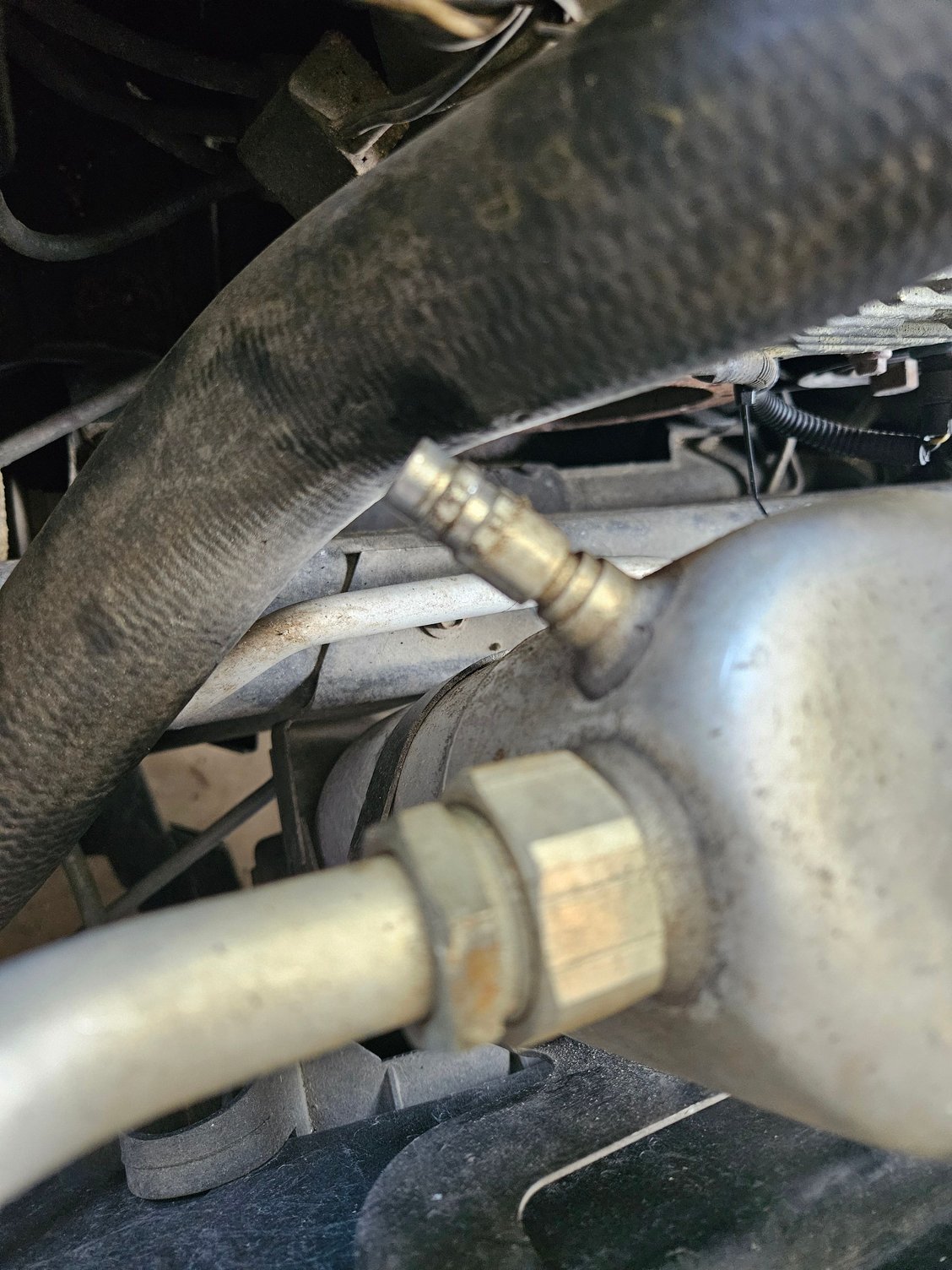

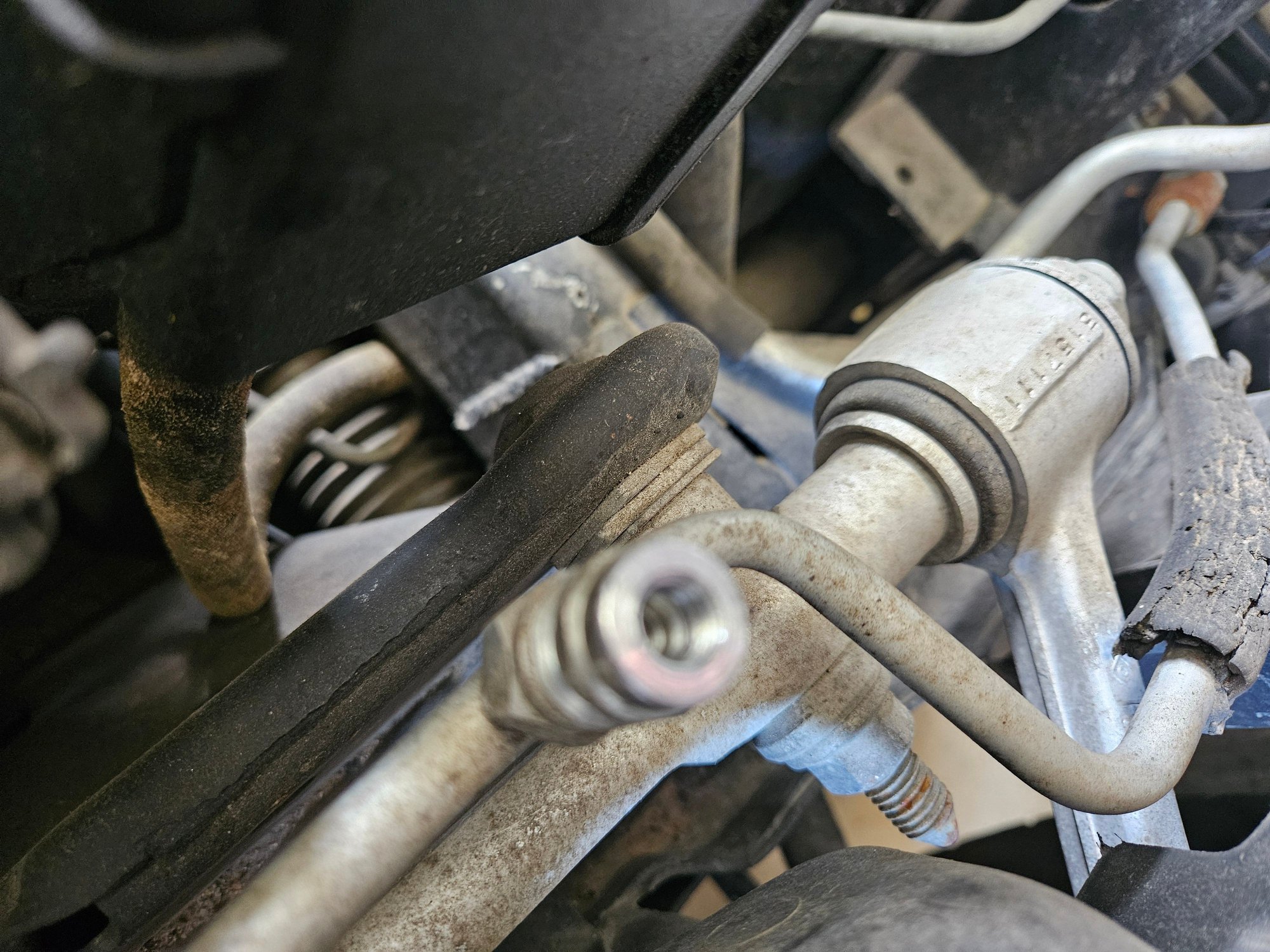

How can I tell if the A/C system has been converted to 134a on a 92? Here are picks of the service ports.

It’s been converted to r134a. R12 is screw type, 134a is “quick connects” like shown in the pics
Perfect thanks, that is what I thought but wanted to make sure. It had a low charge. Tried recharging and started cycling but then stopped. Pulled vacuum and tried charging again but won't cycle now.

Defiantly R134 You got lucky
