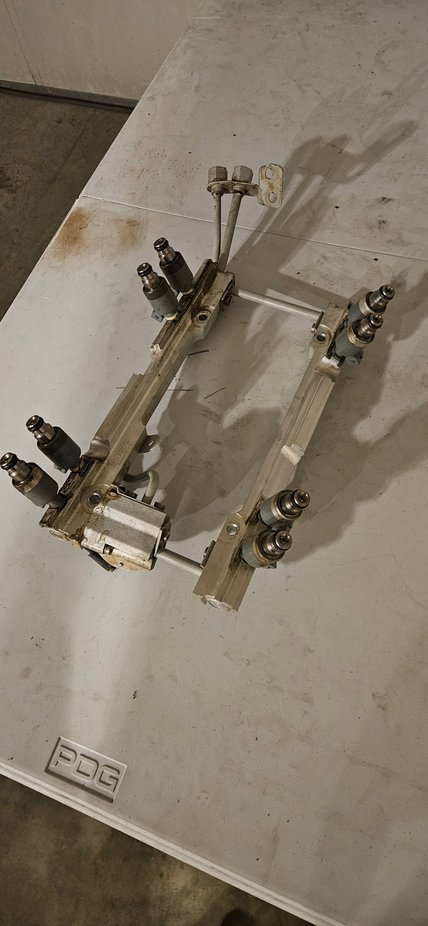

Thank you to everyone for the help and suggestions! Shes back on the road!
After 6 weeks of shipping delays, work trips, and a week of actually getting the job done, finally got the injectors replaced. Runs incredibly smoothly and super happy to have my car back. Once I actually tested the injectors it was a slam dunk on problem ID...only 3 were reading in the right range and one was at 6 so had almost completely failed. The team at injector connection got me a great product but couldn't help tough shipping issues here in N.D.
I did have a shop take care of clogged but not blocked catalytic converter, which wasnt the problem but doesnt hurt anything in the end.
