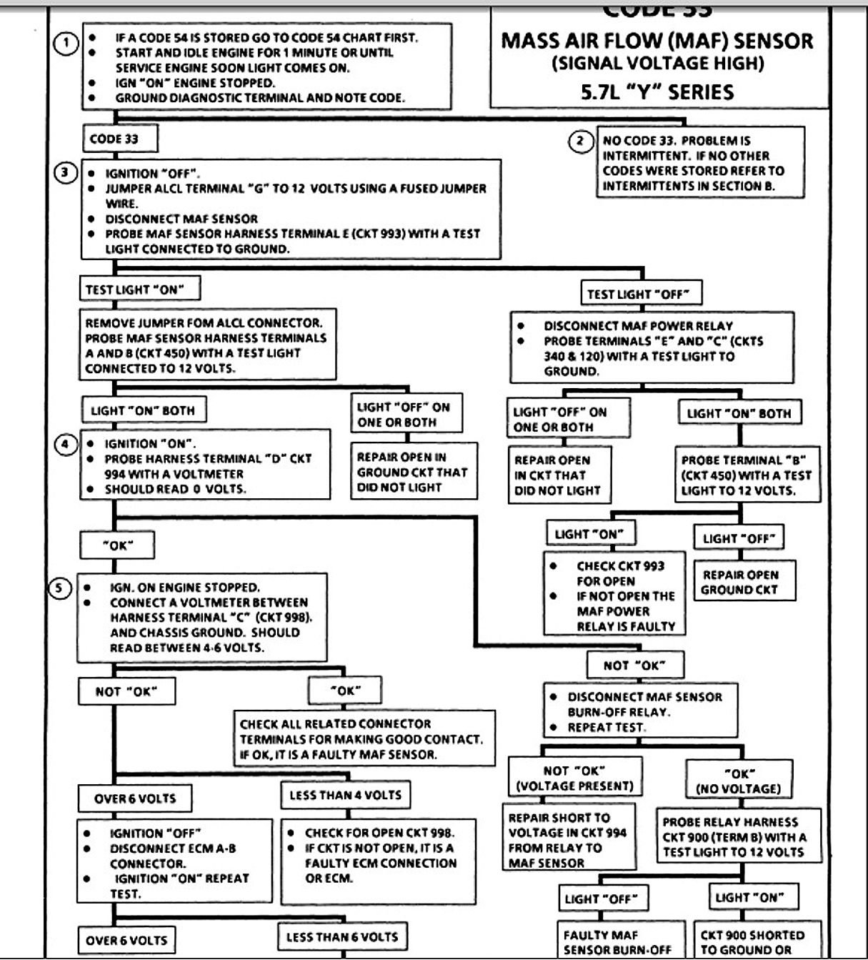

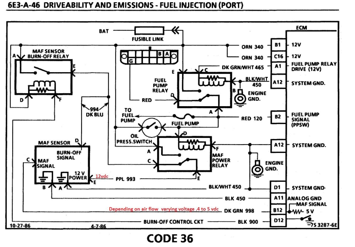

These are some voltages you can check and relays to check.
Old Jul 29, 2025 | 02:57 PM
Vets-Vet's Avatar
Vets-Vet
Joined: Jul 2022
Posts: 1,805
Likes: 365
From: Central Florida

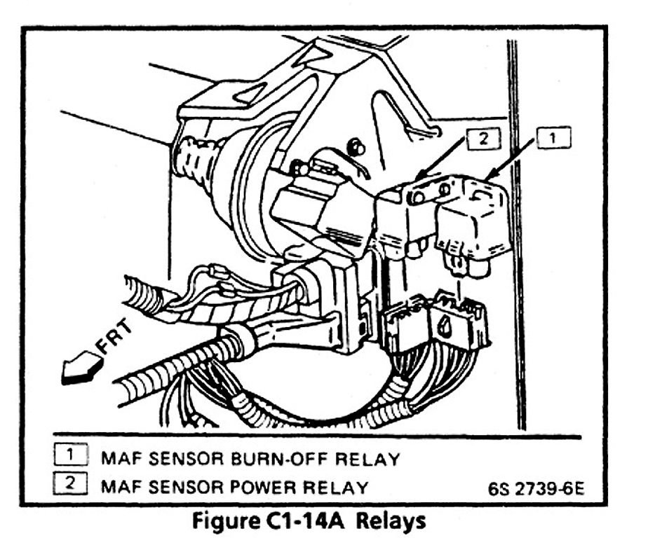

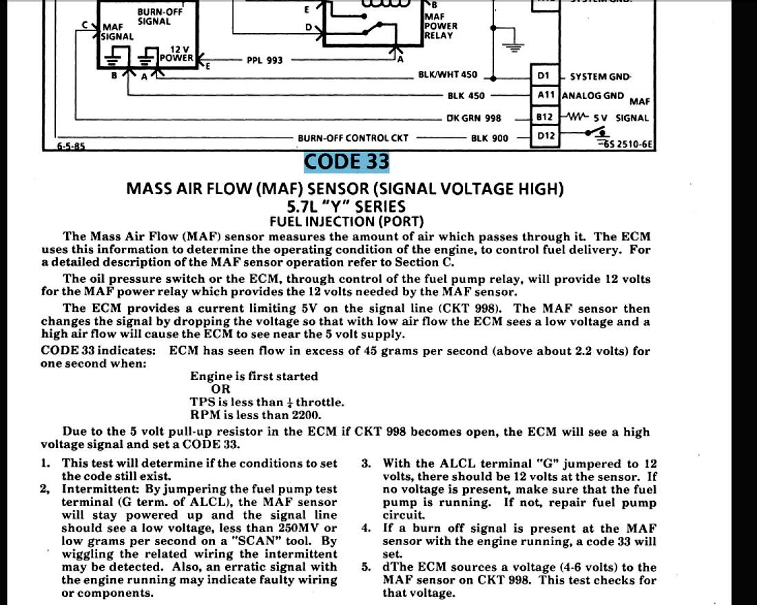

Old Jul 29, 2025 | 03:03 PM
Vets-Vet's Avatar
Vets-Vet
Joined: Jul 2022
Posts: 1,805
Likes: 365

Make sure you check the grounds also. The system ground is always there I am not sure about the analog ground. The MAF power relay is very important as well.
