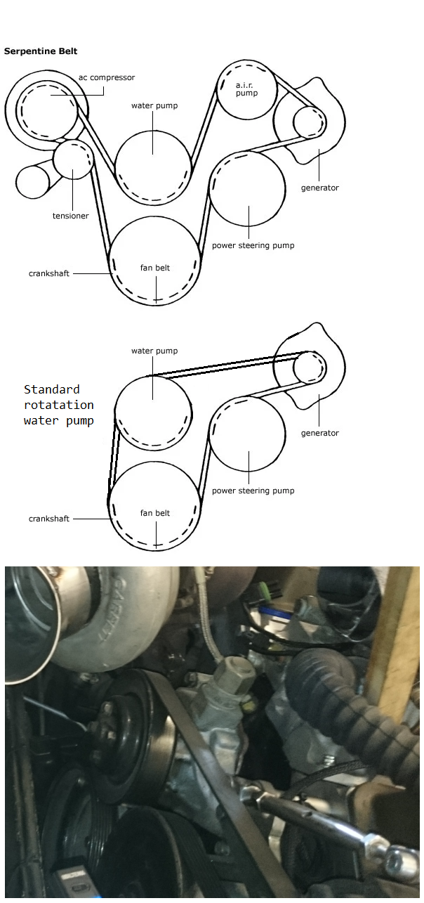

I have a 1989 corvette and am trying to delete the AC. I have tall valve covers leading to my AC compressor being in the way. Does anyone know of an easy fix to removing the AC?

If you are in the process of removing things ....
I changed to a standard rotation "short" water pump and reused the stock pulley.
I removed the top alternator mount and fabricated a belt tensioner from a turnbuckle.
I ran like that for years without any issues.
( As you see I needed the A/C pump space for something else)
