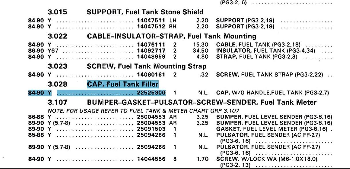

Buy a GM fuel cap with this correct part number and you can't go wrong. Many parts stores have incorrect information. They sold me a non vented cap and I had very high vacuum pressure in my tank.
Thank you! That's exactly what I did... it matches with the one I bought from Rock Auto.
