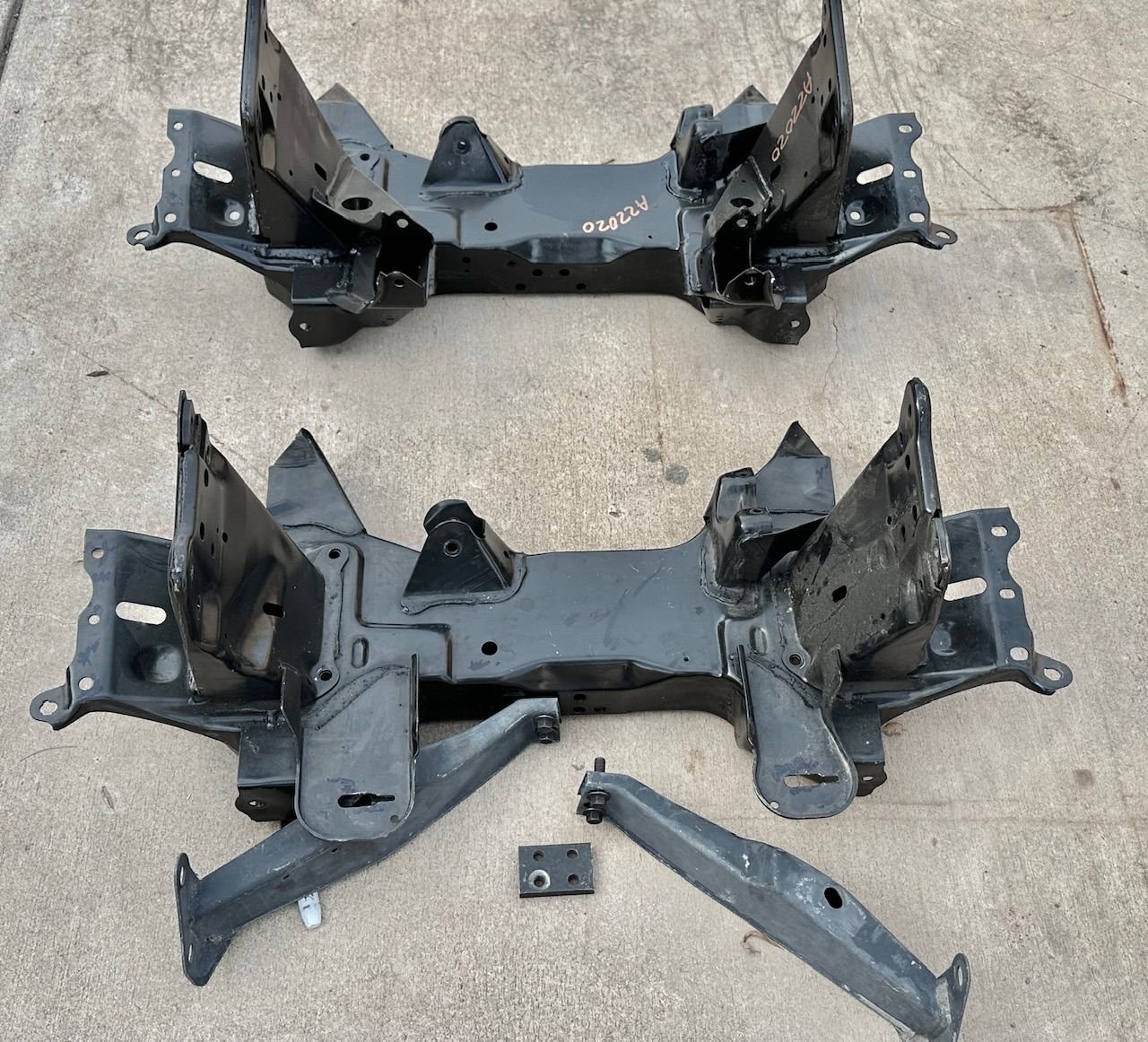

Well I'm not to proud of my possible solution. Everybody has seen the Chain leading from the frame of the Tri Five going to the engine to limet the movement or in case a motor mount breaks. This is my version we will see how it works.

Had I thought of it I would of gone to the LT1 style Cradle when I had mine out for Mods not long ago. Good info to know they are interchangeable.

I snuck in a Stiffener Bar across the Cradle. I think these cars need it and there just isn't a good way of putting anything where it needs to go.
