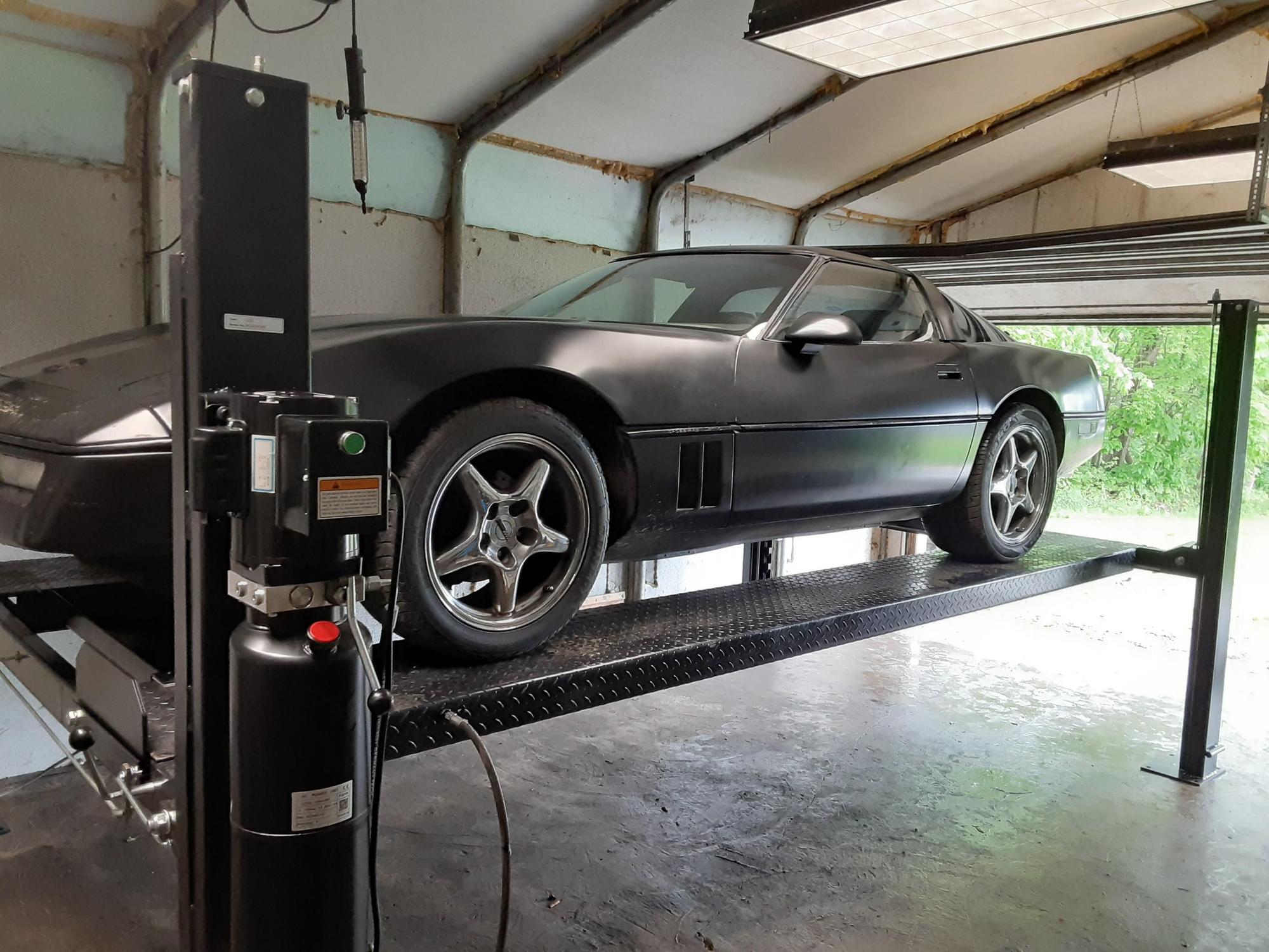

I have a 4 post in my garage. My ceiling isn't that much higher than yours. With an 8 foot ceiling you could comfortably sit under the car in a roller chair. This is what I do most of the time anyway. Mine is a 7000 pound lift from APlus
