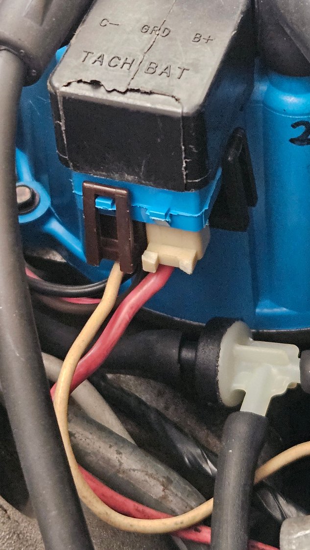

I can find the white tach connector but not the batt connector. What color is the connector and wire?

NAPA, Tech Expert (TEE) P/N: HRK100. Pigtails for both BAT and TACH,

The BAT wire is red. I believe tach is green, but mine is missing so I can't verify.
I needed some myself so I found these on the jungle website.

Here is a pic i just took of mine. The clasp for the BAT connector is broken off. It's an 88.
