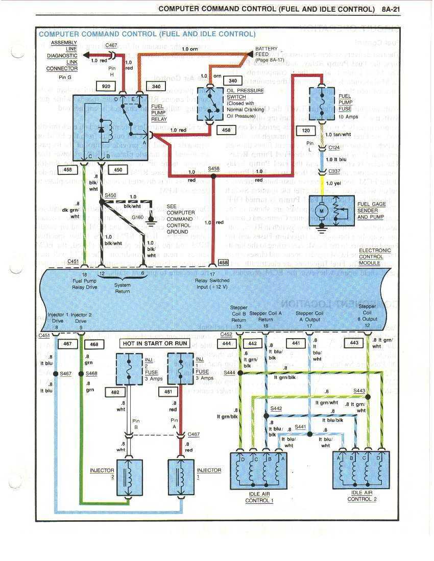

84 c4 350ci crossfire has no start condition turns over no power to fuel pump jump relay E to D no power to pump jump G ALDL no power to pump most likely theft issue. I would like to know exact location anti theft module and inhibiter relay this is really weird to me. if it cranks then alarm is disarmed still no fuel replaced fuel relay freed up door locks anyone have this issue before
Now I could just jumper fuel pump car would run and if I were to do this most likely from e of fuel pump relay but I would rather not will if I have too Help???

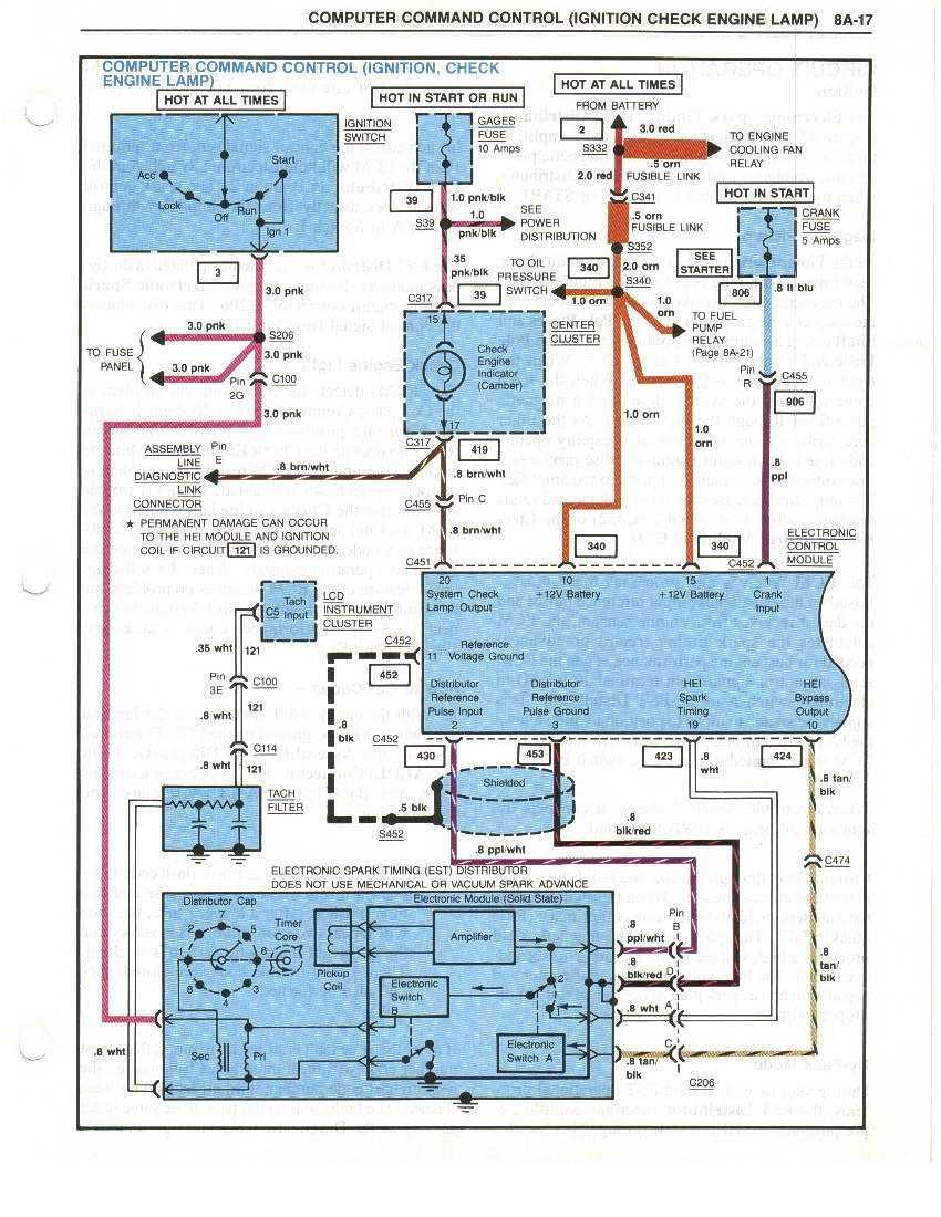

Thank you exactly as you described. now do you you maybe think EST Electronic Spark control module ? and until I get my OBD1 cable and I do have trouble codes 12
33 respectively thx

Error codes 12 or 33 should not prevent start.
Yes, distributor is the first link in the chain.
Do you get spark? Without signal from ECM the distributor will go to "limp home" mode and fire spark anyway.
If no spark then problem is most likley distrubutor related.
If you get spark then it might be fuel related. Power to injectors?
It could also be that ECM does not receive distributor reference pulses and then no fuel pump and no injectors firing.

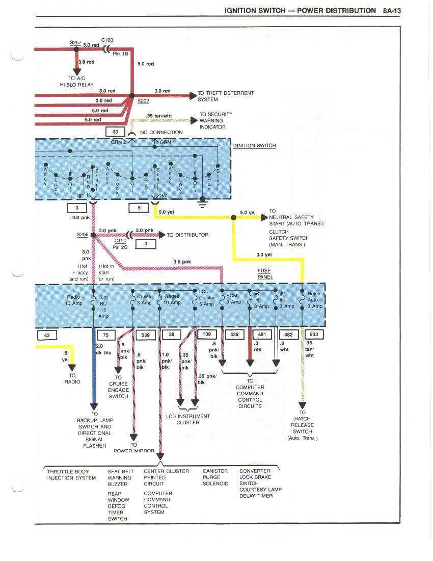

That is probably your main issue! "Start and run" is all in the ignition lock. If you loose power to injectors on "start" position, then you probably also loose power to distributor, ECM and a lot of less important items.
You can measure that on the fuse panel.
For testing you could remove the 15A Turn fuse that is on the same branch from the ignition lock. Use a jumper cable from battery power to the feeding side of that removed fuse socket.
Try starting ... and you need to remove jumper cable to shut engine off if it starts.

Thankyou you know I have a brand new delco ign sw at the house been looking for 3 days I would have got around to this I will replace it tomm let you know how it goes thanks

today replaced ign switch every thing is ok except no power to inj still no power to fuel pump dist pack connector was half locked fine now still can't get to ecm or fuses any other suggestions of course would help

there's two 3 amp fuses in fuse box for injectors. the ECM is on passenger side. remove panel underside of dash. fuses are on passenger side of dash. have to open door

Do you have power to injectors with ignition on? As I understood, you had power with ignition on, but lost power during cranking?
Open passenger door to access fuse panel on the side of the dash.
