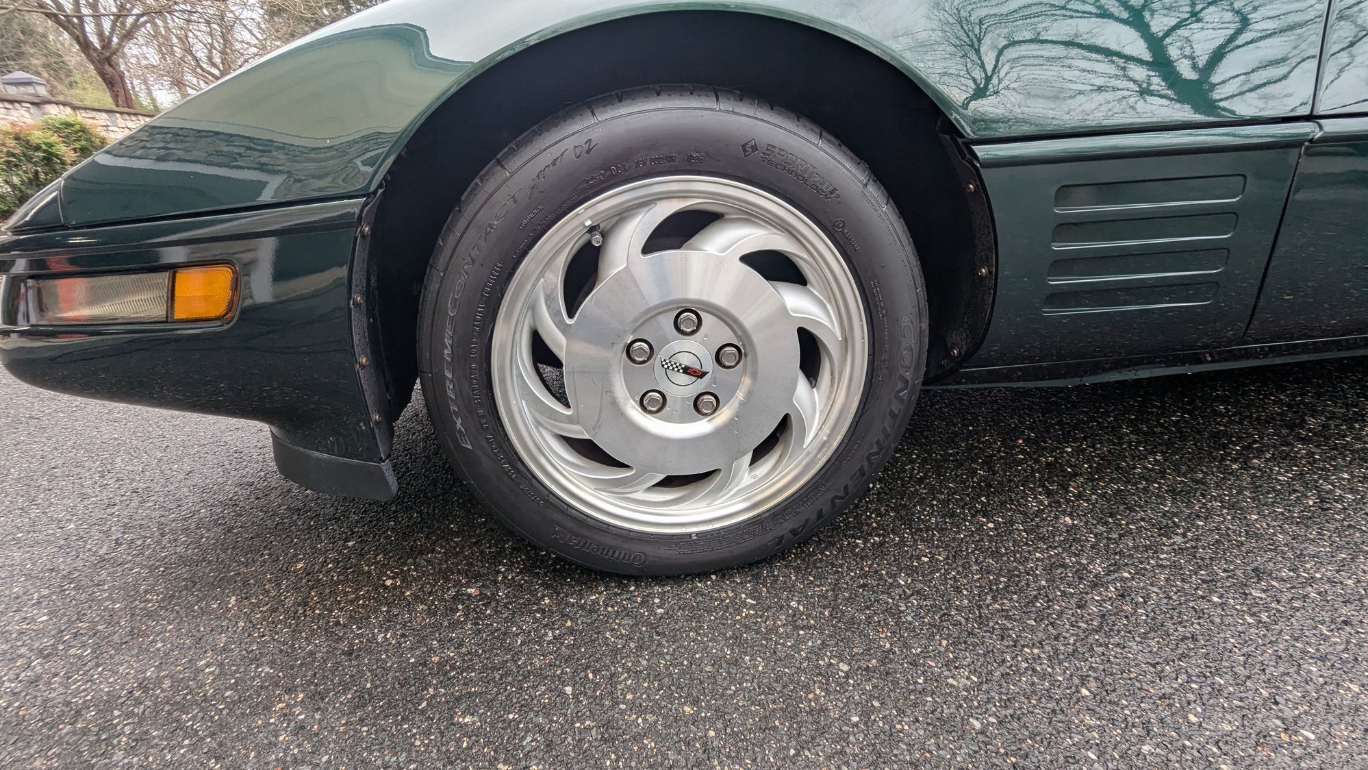

Hey folks,
Just a quick follow-up post after the installation. These tires look and ride great.
