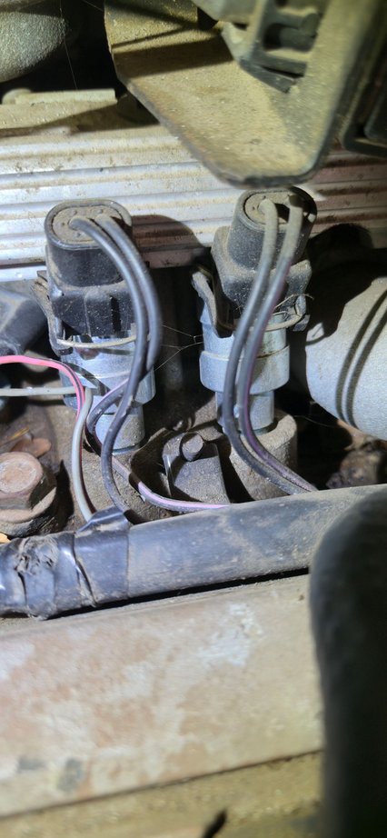

Previous owner bought junk injectors, send us a pic of the injector part number. They can be photographed in place.

Thanks! You put alot in here and I really appreciate all of it firstly after some looking i noticed before I try starting the car the injectors make a weird kind of ticking sound it only happens for around a minute. Also I took a picture and tried to fine the serial numbers for them but I can't. I've attempted to look for vacuum leaks and came up with nothing I'm not really sure where all of the vacuum lines are so I just looked at all of the hoses I could see. The SES light is on but when I put a paperclip into the A and B connectors nothing happens it doesn't even go into diagnostics mode. I doesnt flash at all. It did before this but not now. As for everything else you listed its all a work in progress I get to all of those things.
