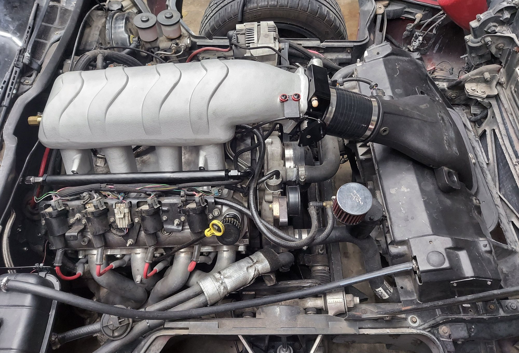

I know, not everyone's cup of tea, but I am doing some more hacking on my krusty gal. Rec port Chinese high ram on the 6.0 w/ LS3 top end. I still have to cut the hood, but I got everything in its final position. I am thinking she will get to somewhere near 480-490 rwhp n/a. I also took out another 60+lbs or so out of her as well. I haven't scaled here yet, but she was 2840 lbs the last time I weighed her. So, she should be pretty skinny and sit under 2800lbs. So, whatever I might be giving up in mid-range tq ought to be decently covered by the weight reduction.
So far, with the intake install, I have only spent about $475. The intake was $368 including tax from Amazon.

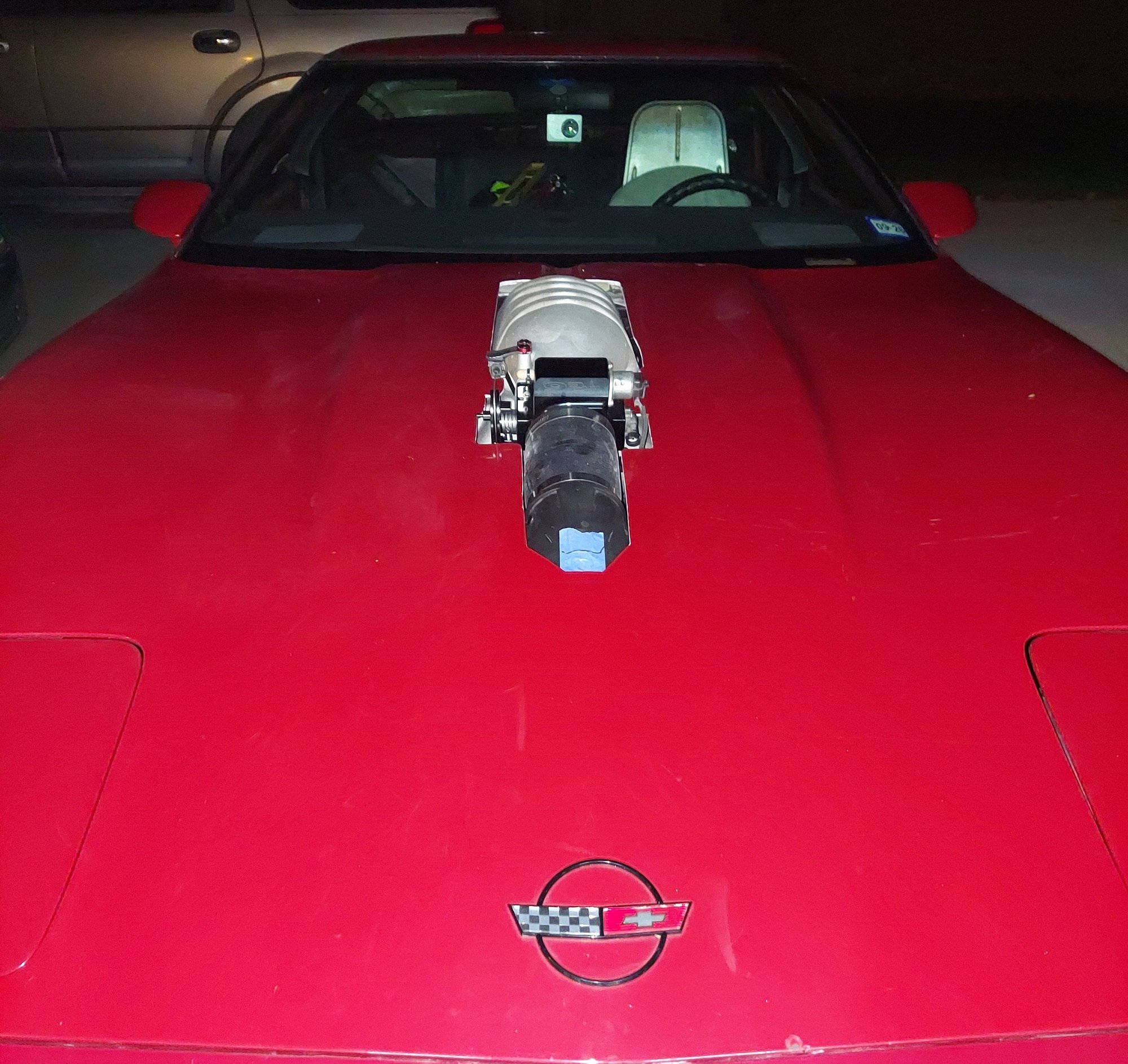

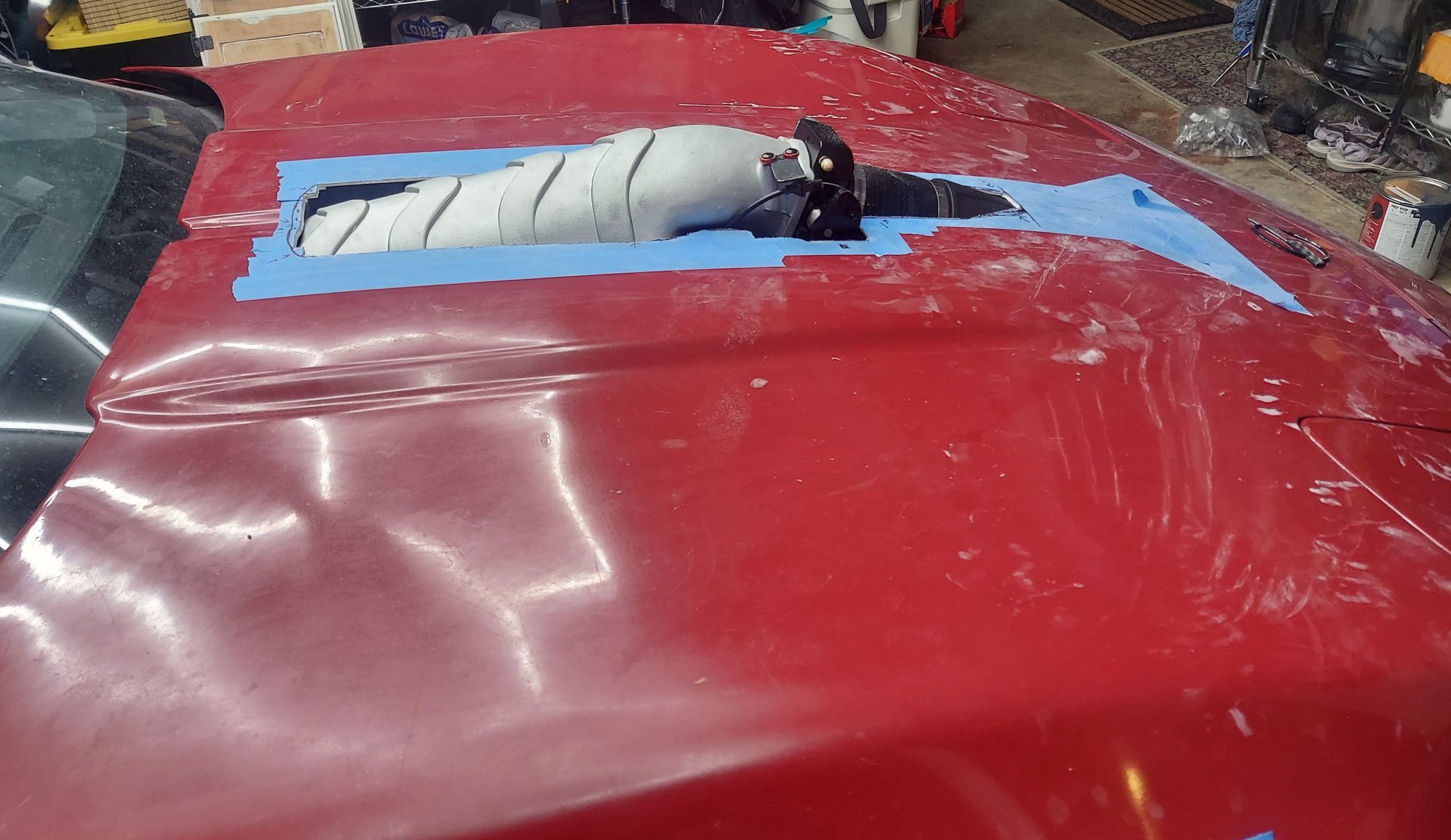

Roughed in. I have another hour or two left to clean it up. I should be able to fire it up Tuesday and do some initial tuning, and then the rubber trim should be here Wednesday.
I didn't have to cut anywhere near as much as I thought. The glass removed for the hole was about 2lbs, and I was able to remove another 8lbs from the under side of the hood to lighten her up. Most of the work needed to be done is smoothing out all of the other cuts I made under the hood.

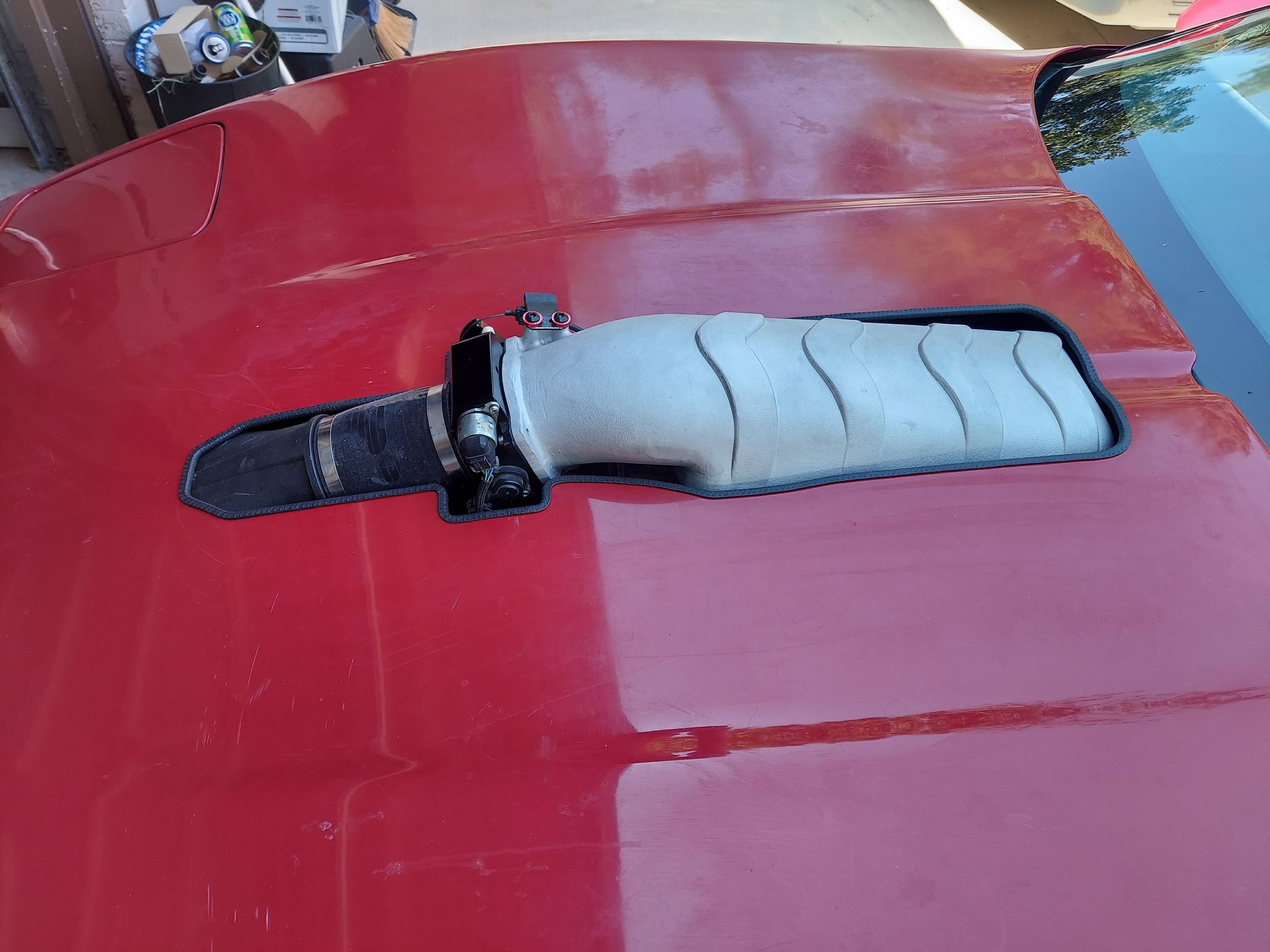

Pretty much done! Now I just have to drive, log, and tune her.
Edit: I did take her out on her first voyage. I kept stopping to make sure there weren't any fuel leaks. I ended up spending more time talking to people that pulled up wanting to look at it than I spent driving it. She is quite a bit more doggish in the mid-range, but pulls like crazy above 5k. I have a lot of tuning to do and feel that I should be able to make her run pretty hard from 4500 on up. I kept banging the 7k limiter because it was getting there quite a bit quicker than before. To take more advantage of it I will likely step the limiter to 7400-7500. Definitely a different feel though, and she is no longer a sleeper. I should be able to get some good seat time in a few days.

The rubber trim really turned out clean! What material is that? I have some uses for it too.

Amazon stuff. It's cheap too. It is definitely worth the price. I bought two 10ft lengths. I have some other uses for it around the car as well.
