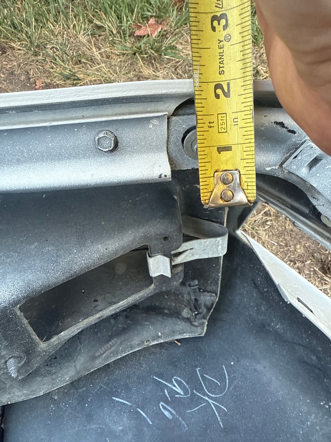

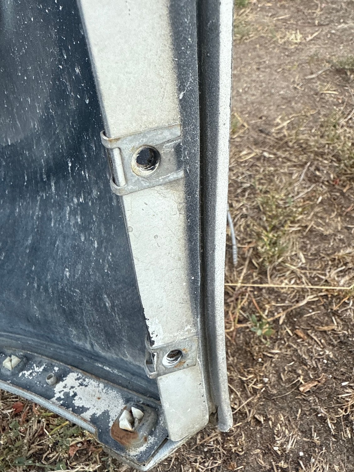

You have made it clear you don’t want to hear about replacement. However, this bumper isn’t like old ones on things like the 69 GTO where they’re difficult to repair but can be. This bumper is plastic. Thin plastic. Any type of filler will not last and that’s why so many of these bumpers have spider cracks under fresh paint jobs. Here’s a picture of a 92 bumper I’m replacing. It’s about 1/8” thick plastic.
Here’s also a pic of a 69 GTO Endura bumper I’ve just restored and used SEM epoxy and special bumper filler followed by Transtar 1201 flexible primer. None of these products would work on the thin plastic of these corvettes. If you have to repair it you would need to use heat and try to get the plastic to reform flat. There are plastic bumper repair kits that are similar to fiberglass repair where you use material, but that is for repairing cracks.
