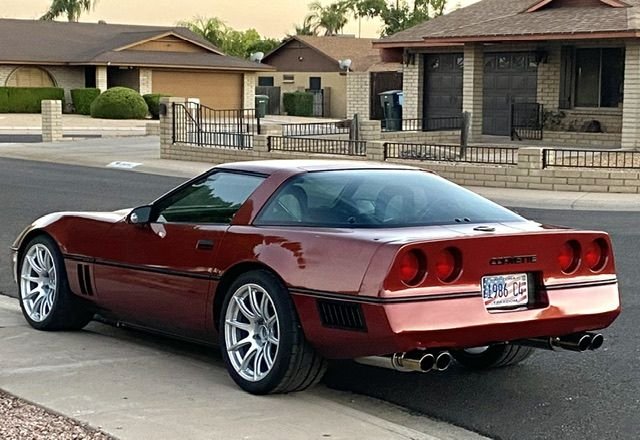

I've run the Widebody C6/C7 front wheel fitment on the 1986 all the way around... actually the aftermarket wheels that are 11" wide and ET36. The 11" in front needed a small spacer to clear the ARB at full lock. The 10" versions work without that.
BTW I have a set of APEX SM10's if you're nearby, went with some forged wheels and new unusual front offset since.
Dave
