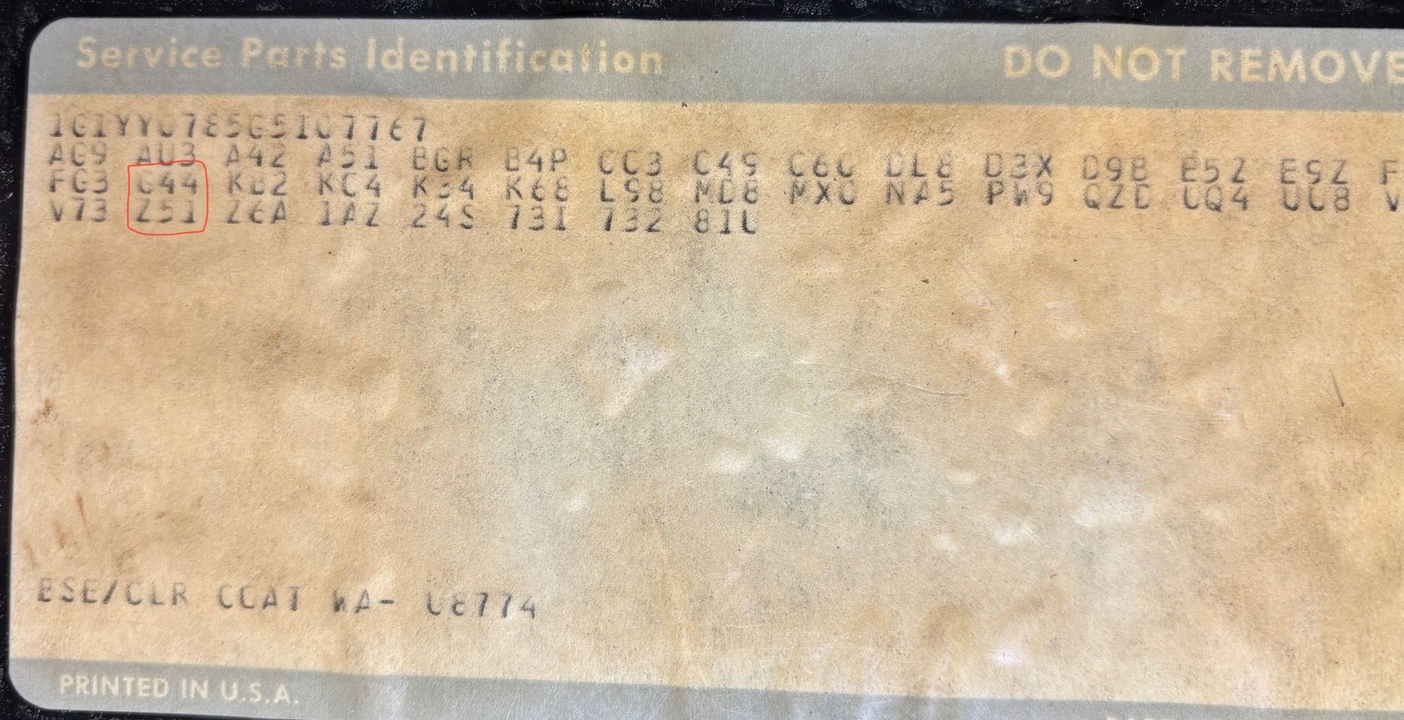

I'm getting ready to rebuild the factory rear end, which will include a new ring pinion.
Found my build code sheet. If I understand this correctly, my car has the 3.07 and the Z51 performance package? I boxed the two codes below:

The build sheet posted is NOT the larger D44 gear but a D36 for an AT/MD8 that the SPID confirms. Why do you feel you need new Ring & Pinion gear set?

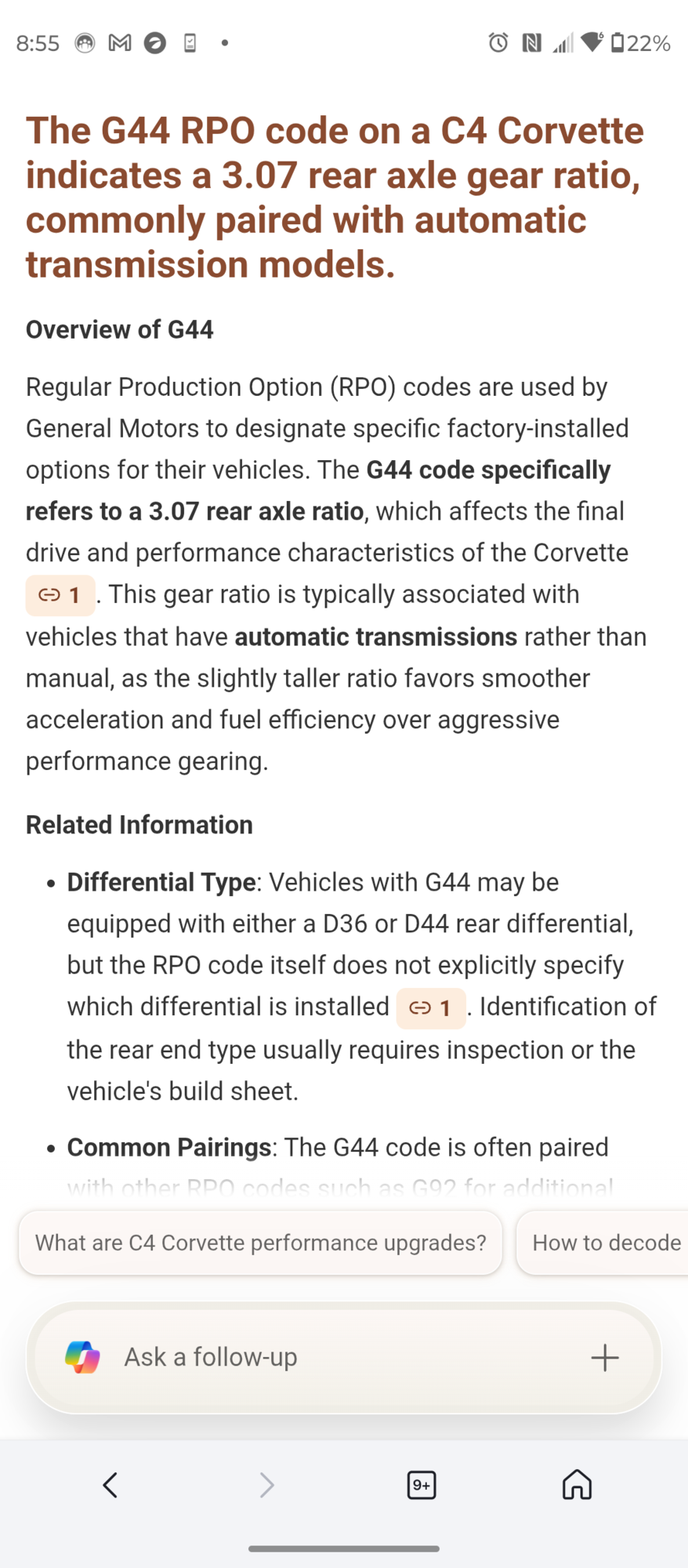

I threw the codes in Copilot - I somewhat trust what I get from there, but like to verify.
Correct on the D36 - my car has the 700R4

So long as you buy for D36 you're good. I imagine that a new D36 3.07 ring/pinion might be a difficult find and that's actually why I mentioned the first move be a service of what you have. If you're actually doing a rebuild aside from what you would normally consider I believe it wise to also replace the pinion differential thrust washers. Dana/Spicer part # for reference should be 40266 and you need 2. They were also used in the Jeep D35. Most critical first check I would think to be the fit of the differential pinion shaft to the case.
