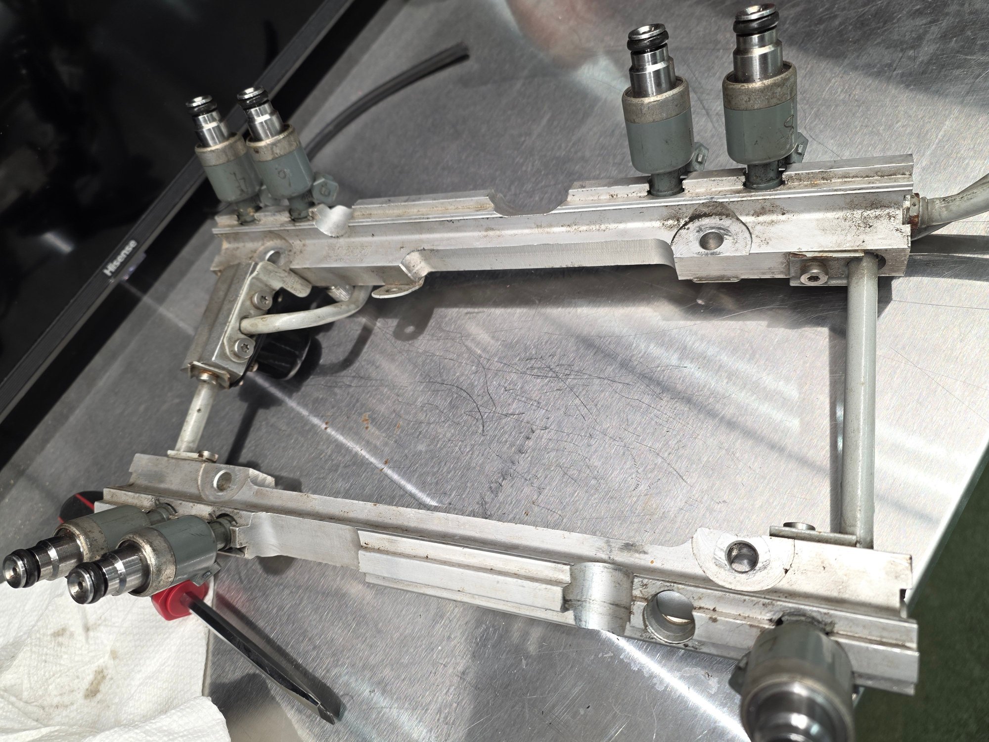

I actually just finishing removing them as we have 8 new Delph FJ10024 arriving later this week.
Existing injectors look like they've been tinkered with as someone has removed and numbered them.

Originally Posted by Ratboy
The original injectors are a known common fail. I would be odd for all of them to fail, but if it runs on ether, your problem is clearly fuel delivery. You can test them with a 9v (transistor) battery, but if they're original, they need to go.
I'm not sure if these are original or not? Im new to working on C4s. Here's pics of what I just removed. As mentioned earlier, someone engraved them with cylinder number, so Im assuming they're original but were rebuilt somewhere between 1.5 - 3 years ago.

Those are original Multecs.
