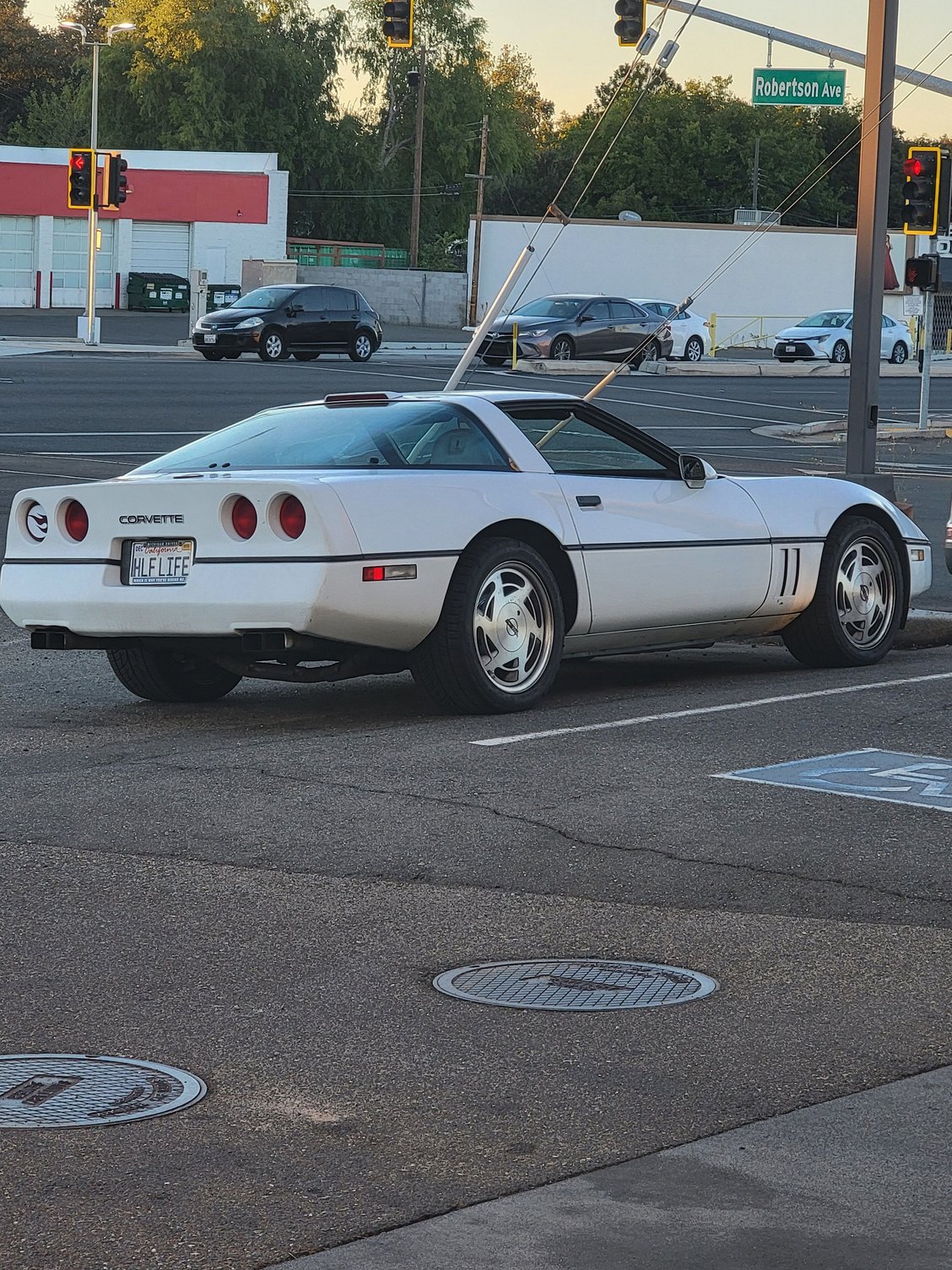

I have 244000 miles on my 89 and it's puffing a little blue smoke. I'm running 5w30 high mileage. At my next oil change should I run a quart of Lucas or marvel mystery oil? Should I bump up to like a 5w40 synthetic? Any advice is appreciated. Thanks!

How about changing your valve seals? You could do it yourself, start to finish on a Saturday! If you been running "high mileage" oil, the additives in those types of oil have already "swollen" the seals in your engine, to aid in sealing. I wouldn't use any additive or change oil viscosity. Do an internet search for changing valve seals at home. You could go with o-ring and umbrella type seals, but I would recommend the use of "positive lock" style seals on both the intake and exhaust. You'll need the seals, valve cover gaskets, new spark plugs, a manual valve spring compressor tool and a special hose made to thread into the spark plug hole on one end and hook to compressed air on the other end (compression tester kit). It's tedious and you'll have to properly set your rocker-arms again when finshed....but this is the right solution to your issue! I love seeing "road warriors" like your corvette, it looks great for the mileage driven, fix it right and keep adding to that odometer!!! I have to mention your license plate, is it a reference to a certain element, or do you happen to be a chemist or physicist? Anyway, sweet car, awesome that it's enjoyed and I'd do right by it and fix the actual cause of your puffs of blue smoke! Good luck whatever you decide to do, but the cure doesn't come in a can👍

Eventually I plan on a full rebuild. But at the moment I have to get it to pass smog. And it won't if it's blowing smoke. The plate was meant to be a different version of "midlife" since the corvette is the "mid life crisis car" lol

i thought the plate was referencing the game.
