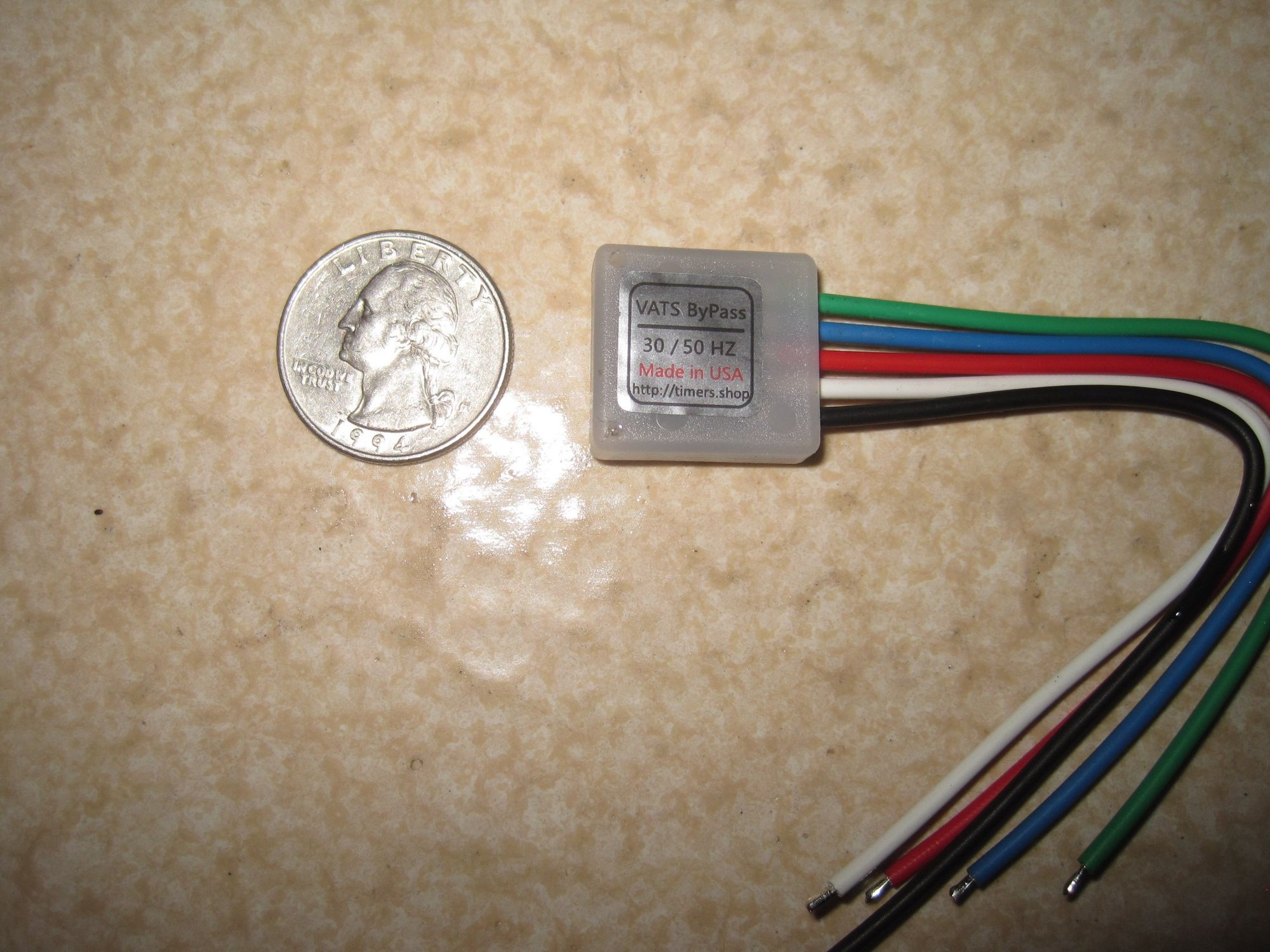

In a 1986-1989 it is normal for the SECURITY light to flash when the key is in START. It is the way the module is wired. The SECURITY light is not wired to the VATS system. The SECURITY light is only associated with the Universal Theft Deterrent. The "alarm". In a 1986-1989 there is no visual indication to the driver of VATS status. Nothing.
If you CAN hear the relay click (and you are CERTAIN that the relay you hear is the starter relay) the VATS module IS energizing the relay. In a 1986-1989, the relay contacts are Normally Open, and the VATS module provides a ground to close the contacts when the key is in CRANK. If the starter relay is clicking, the module is providing the necessary ground. << It is not "VATS". But it COULD BE the relay contacts. Ie, the relay is bad.
You report that there is no power at the starter. There are other possibilities. After the relay, the circuit goes through the P/N switch (automatic) or the clutch safety switch (manual). If you have a 6-speed, the clutch safety switches are known to be problematic.
Another diagnostic for when it will not crank, pull the codes. Check for the presence of Code 46. If Code 46 is NOT present, it is NOT "VATS".
So I was wondering if there was a way to jump power so that the ECM is also fooled if the vats is not working.
The answer is in post #3.
Here's a picture of it:

Thanks.,,, I found the problem. It was the clutch safety switch. I was looking at the wrong switch. There are 2 switches on the clutch pedal. The first switch you see is the cruise control disengage. You have to look much higher up to the top at the pivot point to find the starter safety switch. I pulled the plug and jumped it, then it started immediately.
Thanks for the nice part picture of the bypass timer. I went to site address on part in the pic and found it. That's exactly the kind of thing i was looking for but didn't know where to find it so thanks again.
